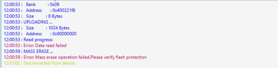

I’m developing a custom external loader for a GD25Q64E flash device and cannot get STM32CubeProgrammer to read/write/erase the external flash. I’ve attached a screenshot of the error reported by the programmer.
What I’ve done
  • Followed the ST tutorial “External QSPI loader how to” External QSPI loader how to - STMicroelectronics.
  • Verified read/write/erase work when exercised from main.c — no errors there.
  • When running the loader, I see a hardfault reported in the CubeProgrammer “HardFault” tab. There is a hardfault at the end of loader_src.c in init(); I’m not sure whether that is expected.
  • Project uses SPI3 with DMA and interrupts to talk to the external flash.
    • I have also tested this with just polling and verified read/writing/erase work when exercised from main.c
Device and external flash info
  • Flash: GD25Q64E
  • SPI instance: SPI3 (Polling)
Questions:
  1. Any troubleshooting tips for getting the custom loader working with STM32CubeProgrammer (and diagnosing the hardfault shown in the programmer)?

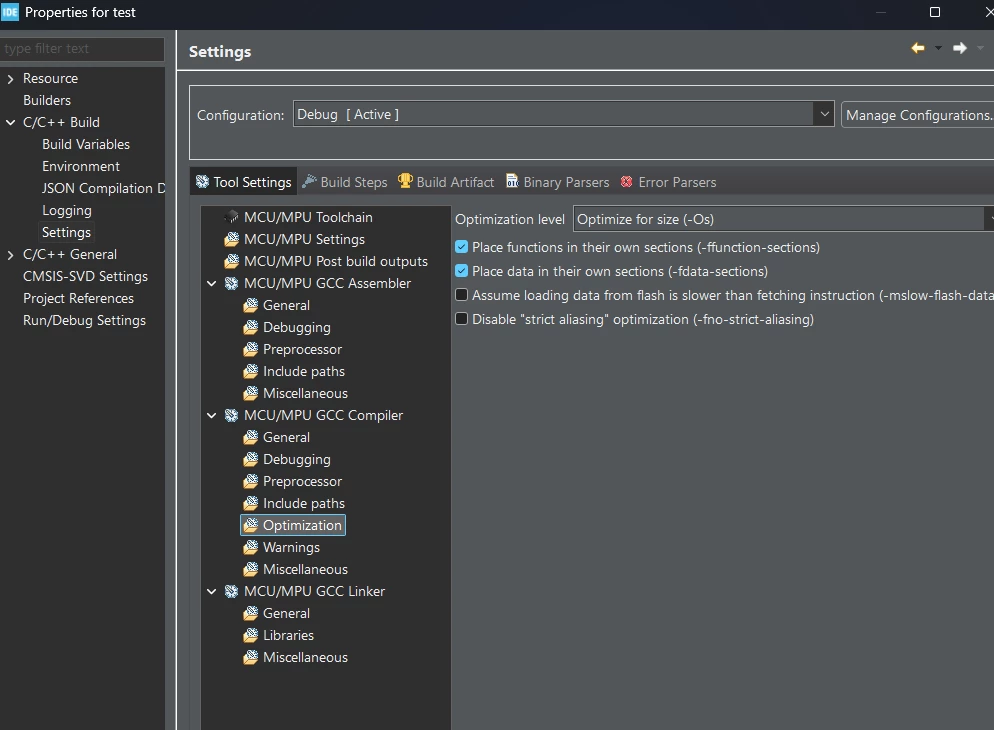

Hi ​@A_Bit_More,
Try adding optimize for size in your IDE and let us know if it resolved the issue.
Aziz
Sep 8, 2026 7:23 PM UTC
Where can I find this in the ide?
Aziz BRIGUI
Sep 9, 2026 8:59 AM UTC
It can be found in “Project properties → C/C++ build → Tool setting → Optimization”
Sep 9, 2026 12:52 PM UTC
Tried it and sadly it’s still not working.

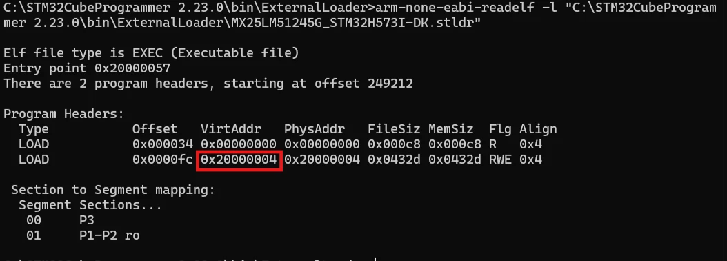

Hi ​@A_Bit_More,
Could you also try changing the start address of the external loader to @0x20000004, this is done with default external loaders coming with STM32CubeProgrammer:
