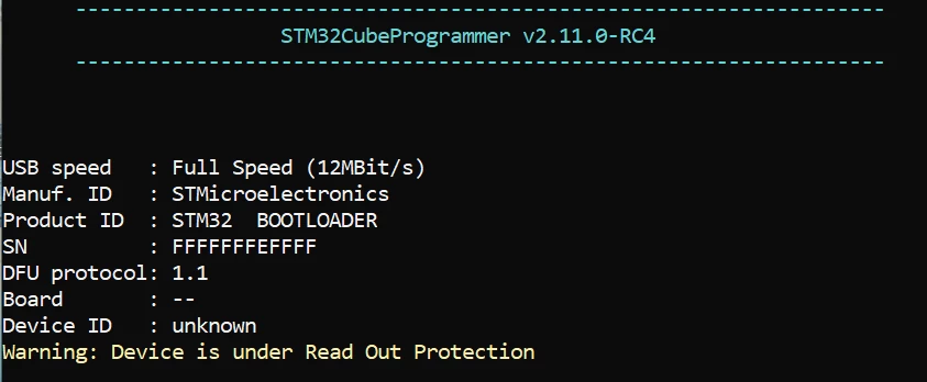

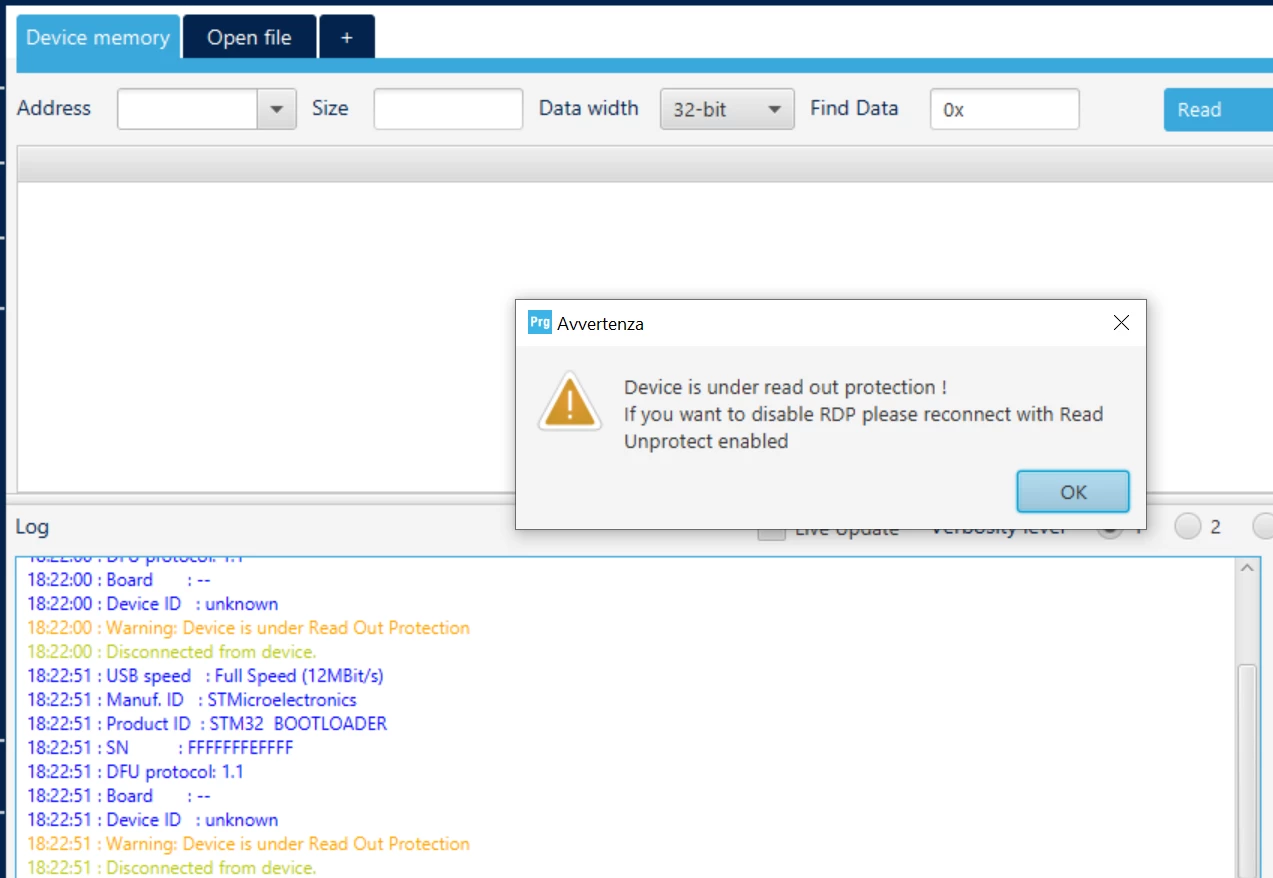

However, on some PCs, the following warning appeared, and no matter what we tried (flag set on "read unprotected", power cycles..etc), we weren't able to connect to the device:
Strange thing is, on those problematic PCs, if, instead of using the embedded laptop USB port, we connected the device through an external USB HUB, we were able to connect properly.

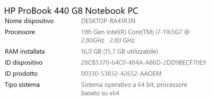

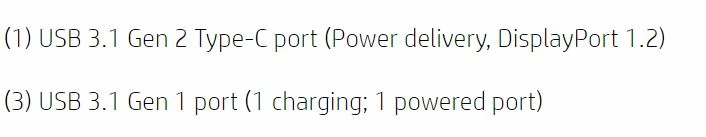

Hello, here are the specs of one of our problematic PC, we have bunch of them in the company and they all fail to connect:
0693W00000Nt4CNQAZ.jpgOperating System: Windows 10 - 64bit
All of the above USB ports do not work
Please let me know if you need some other specific details to help you find the issue.
Thanks!

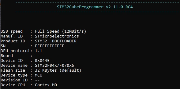

Hi and thank you for your prompt support, unfortunately it did not work, here is the result:0693W00000Nt7F5QAJ.pngI tested the SAME DEVICE on my PC and it gets recognized correctly:

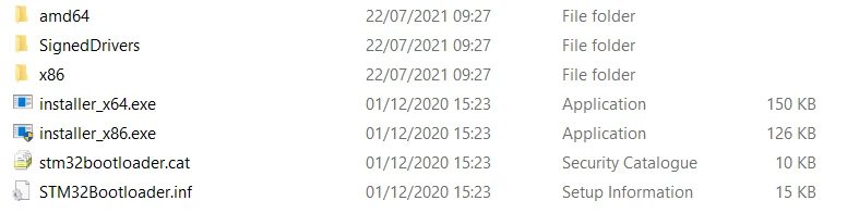

Like i said before, i'm pretty confident that the issue lies in the DFU_Drivers:
0693W00000Nt7JvQAJ.pngthe reason i'm saying that is because we're using this library:
https://github.com/IntergatedCircuits/LibUsbDfu
to perform DFU operations with a custom C# application that we wrote and we're getting the SAME error of the STM32CubeProgrammer. The only thing common to both program is the DFU_Driver (which we install upon the installation of our C# applicataion by calling "STM32Bootloader.bat" inside the path: STM32CubeProgrammer\Drivers\DFU_Driver)
