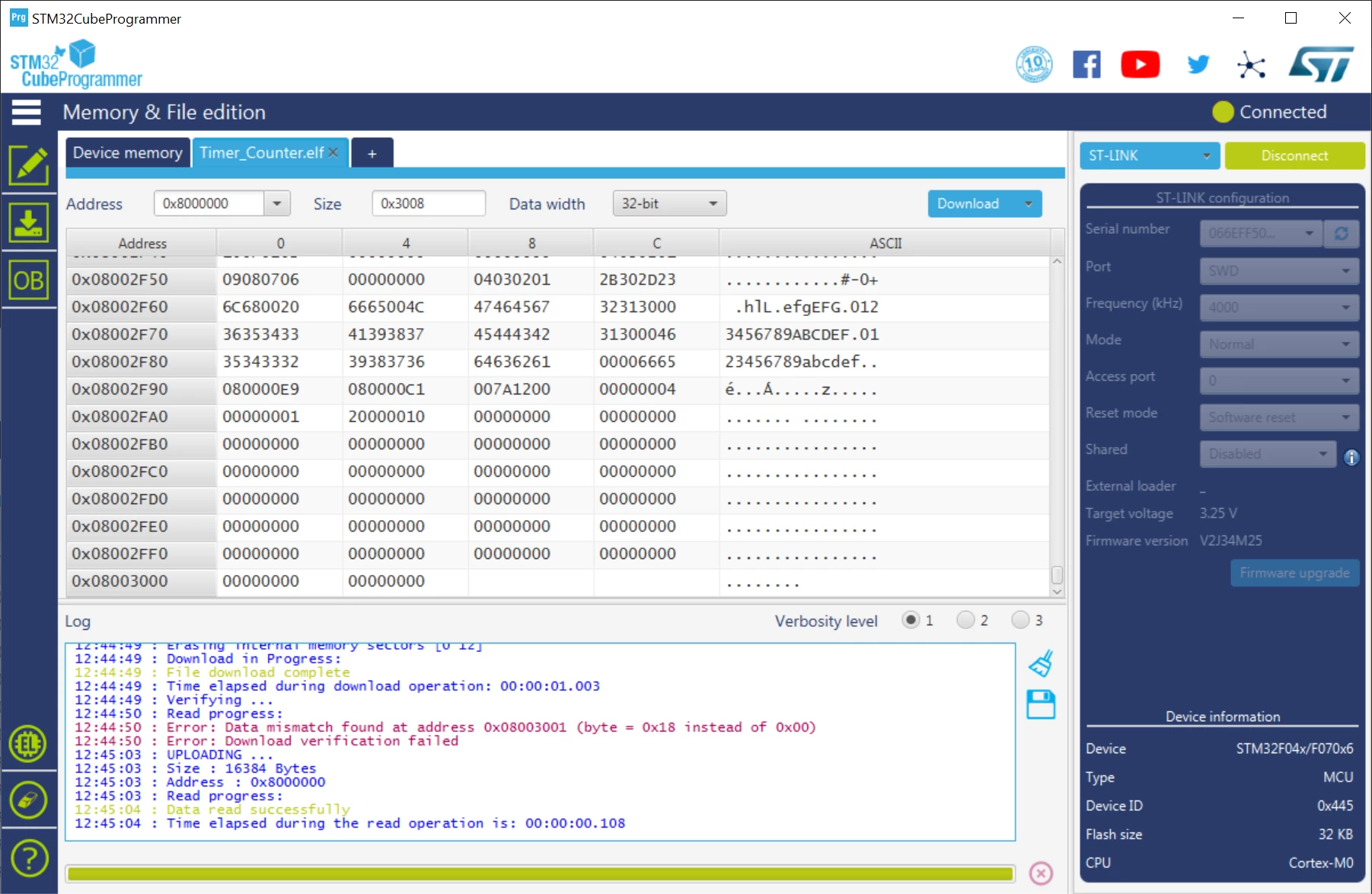

[BUG] STM32CubeProgrammer "Error: Download verification failed" only for some specific file size.
Tools used:
STM32CubeProgrammer 2.3.0.
STM32CubeIDE 1.2.1 for code generation
(gnu-arm-embedded.7-2018-q2-update.win32_1.0.0.201904081647)

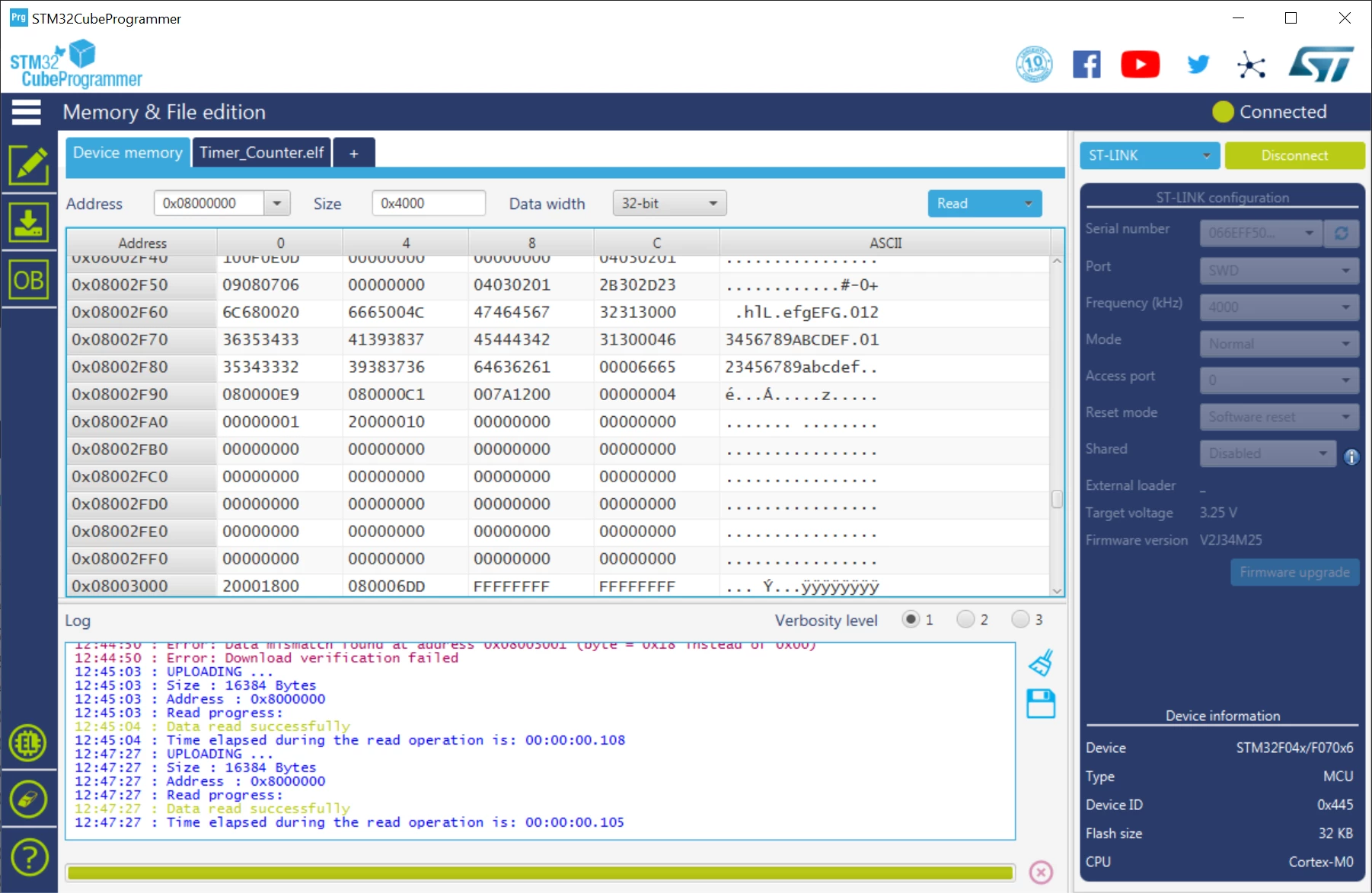

I generate some simple STM32CubeIDE C project with default settings.
Build completes, but debugging throws an error during the program+verification phase with "Error: Data mismatch found at address 0x08003001 (byte = 0x18 instead of 0x00)".
Log file attached.
Same when running STM32CubeProgrammer stand-alone.
The two screen shots show the difference between .elf and flash mem at 0x08003000:
The device was completely erased beforehand.
A generated .bin file also shows 00 00 00 00 00 00 00 00 at offset 0x3000.
When I add some dummy code, the file size increases and verification passes and debugging runs without errors as expected.

I've had the same problem, worked around it by changing ALIGN(4) to ALIGN(16) at a few places in the linker script.
https://community.st.com/s/question/0D50X0000BcRdMKSQ0/flashing-stm32f0-fails-in-cubeide-when-the-firmware-has-a-certain-length-0x1c04-or-0x1c08-bytes

Of course it's still a bug in STM32CubeProgrammer. ST-Link Utility can write a .hex file having the same length and contents without problems.
Apparently STM32CubeProgrammer fails on the STM32F0 series when it tries to write 4 or 8 bytes into a flash page.
