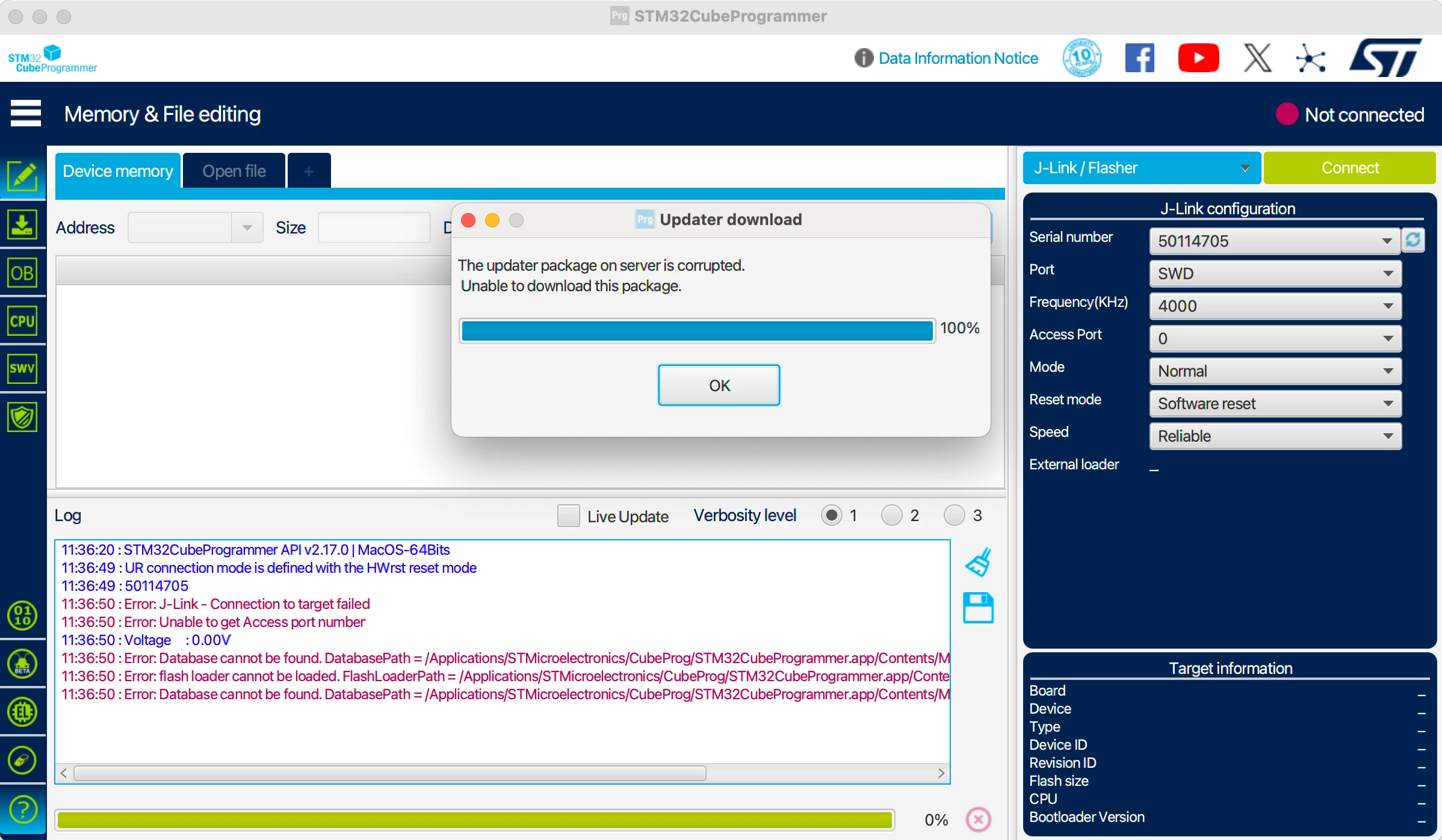

I was updating CubeProg on MacOS 14.5 and had a few issues, but first IT WORKED. It let me know that administrative privilege is required (it isn't), but it plowed ahead and worked anyway.
Here are the things that I ran into:
It does this on 2.16 as well as 2.17, but if there is an update it says that it will install from a local repository (?) and continues successfully.

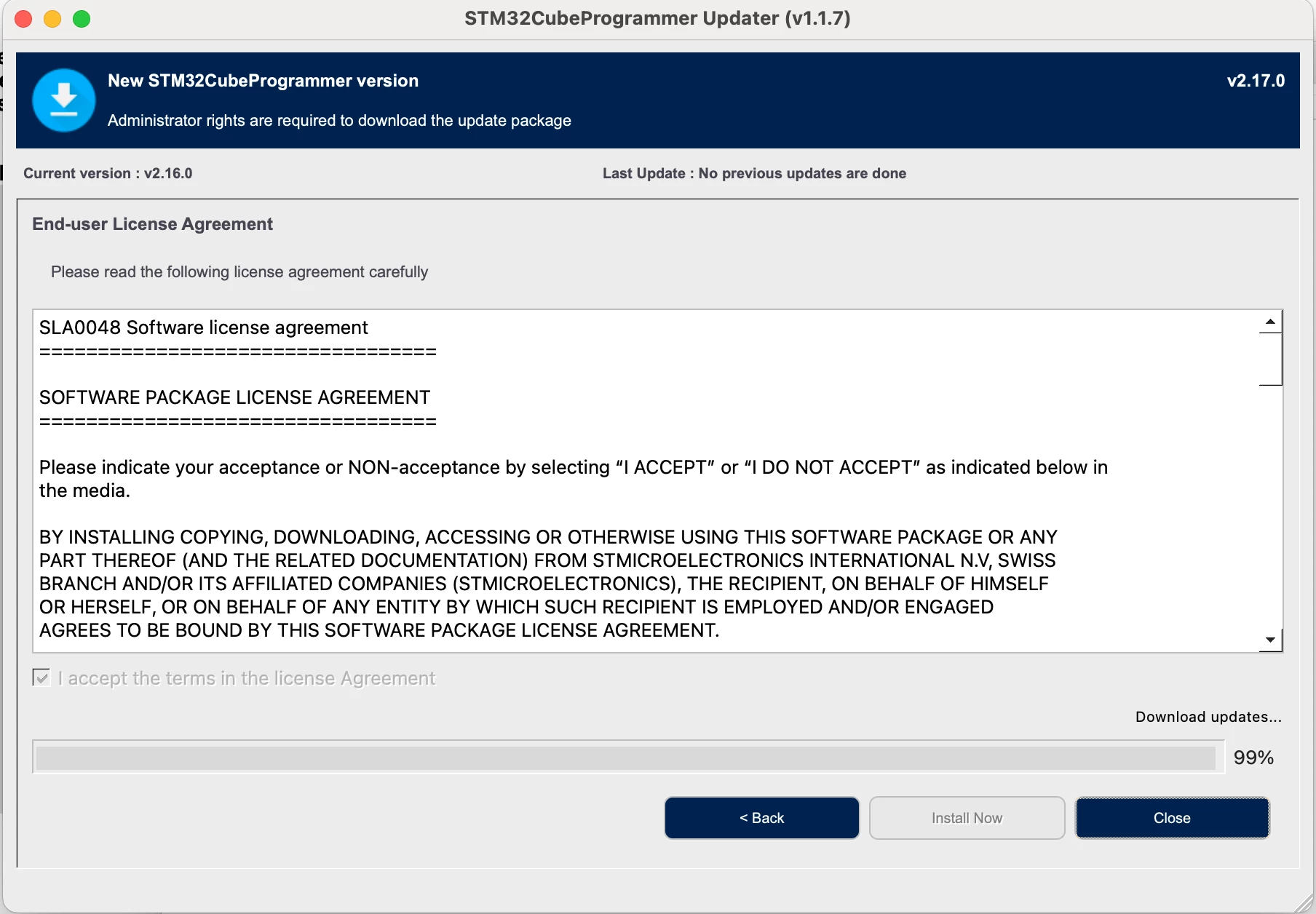

Next:
Here we see that we should choose "I ACCEPT" or "I DO NOT ACCEPT", but the only affordance is "I accept the terms in the license Agreement". Pedantic, but that's your normal audience.

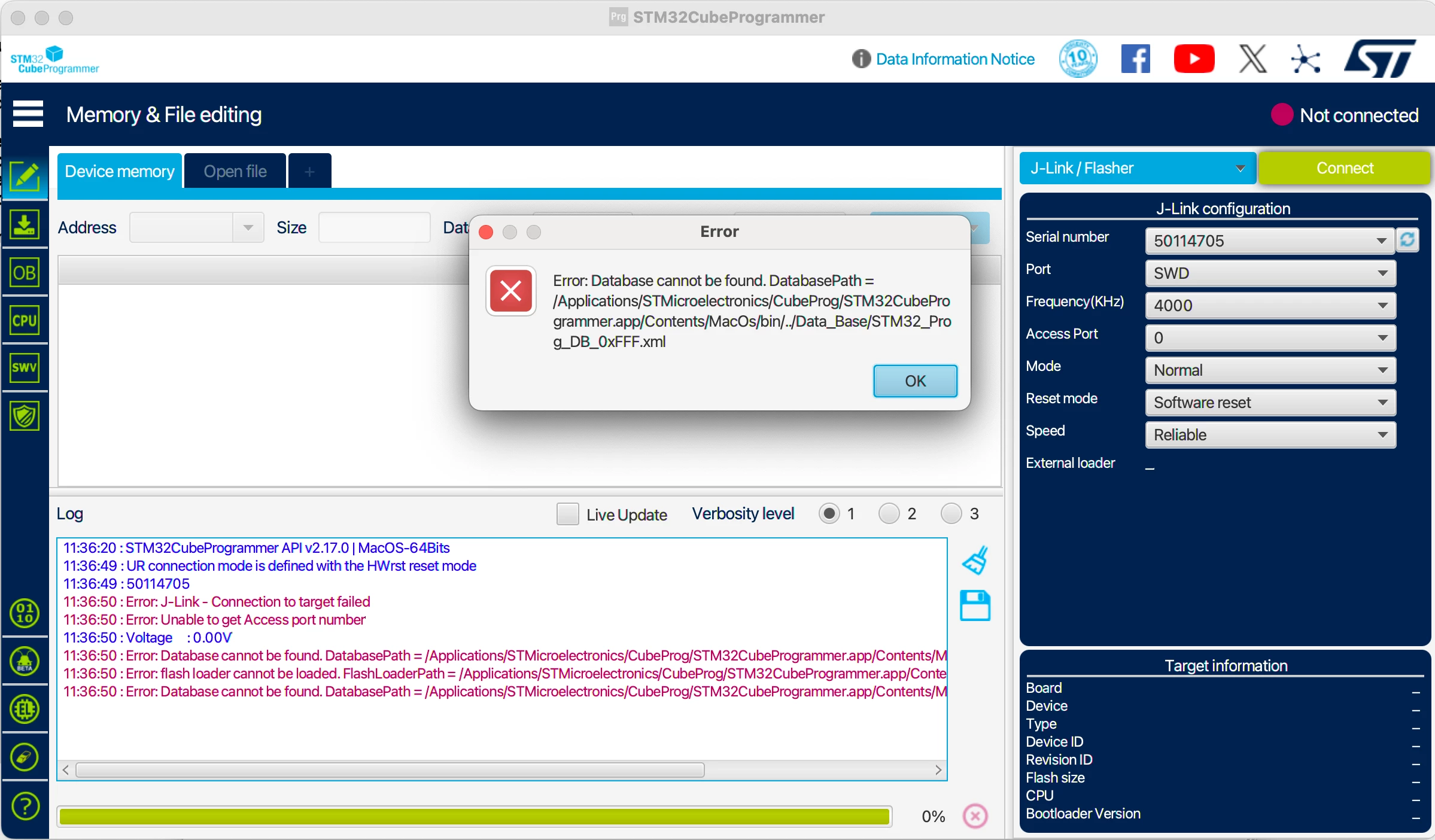

Finally when I try and connect using a J-Link, I get:
I got this with 2.16.0 as well as 2.17.0.
