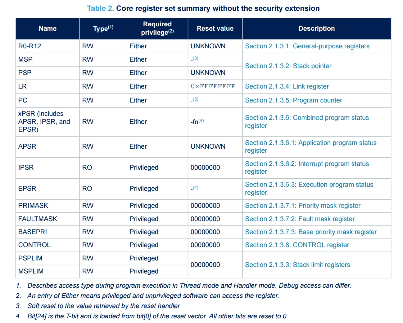

The code shown above reset the PSP pointer rather than MSP. I’m not sure if I do some misunderstanding about the stack pointer, as PM0264 indicated that MSP should be the one reset to the value retrieved by the reset handler.

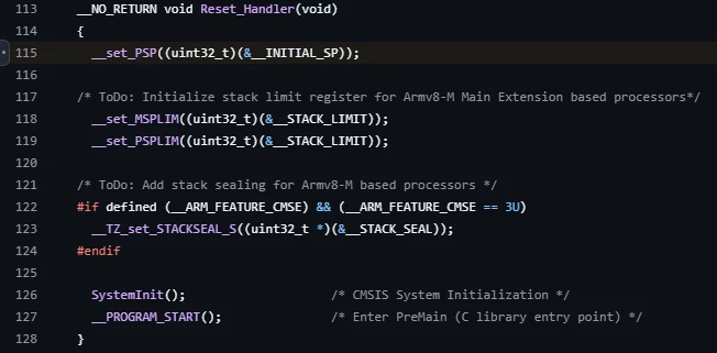

Hello ​@Higashitani_Yuki
STM32C5 device startup files are aligned with CMSIS 6.3.0
https://github.com/ARM-software/CMSIS_6/blob/45dab712ad84f8cbbf2b7bfc089c19088507df6f/CMSIS/Core/Template/Device_M/Source/startup_Device.c#L115
Reset_Handler does not explicitly initialize the MSP.
The MSP is initialized automatically by the Cortex-M hardware during reset:
  1. The processor reads vector table entry 0, __INITIAL_SP.
  2. It loads that value into the MSP.
  3. It reads vector table entry 1 and branches to Reset_Handler
In order to give better visibility on the answered topics, please click on 'Best answer' on the reply which solved your issue or answered your question. Saket_Om

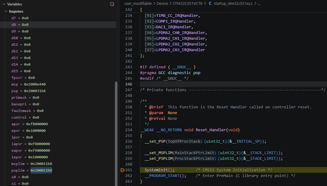

Hello ​@Saket_Om
Thank you for your reply.
In fact, I meet a critical problem when I keep my STM32C5 board power on and try to download a different firmware with totally different stack requirement. As shown in the following screenshot, the PSP was set to the __StackTop(0x200031b8), but the MSP was not initialized. As a result, the process crashed with a STKOF fault after setting the MSPLIM into  __StackLimit(0x200011b8).

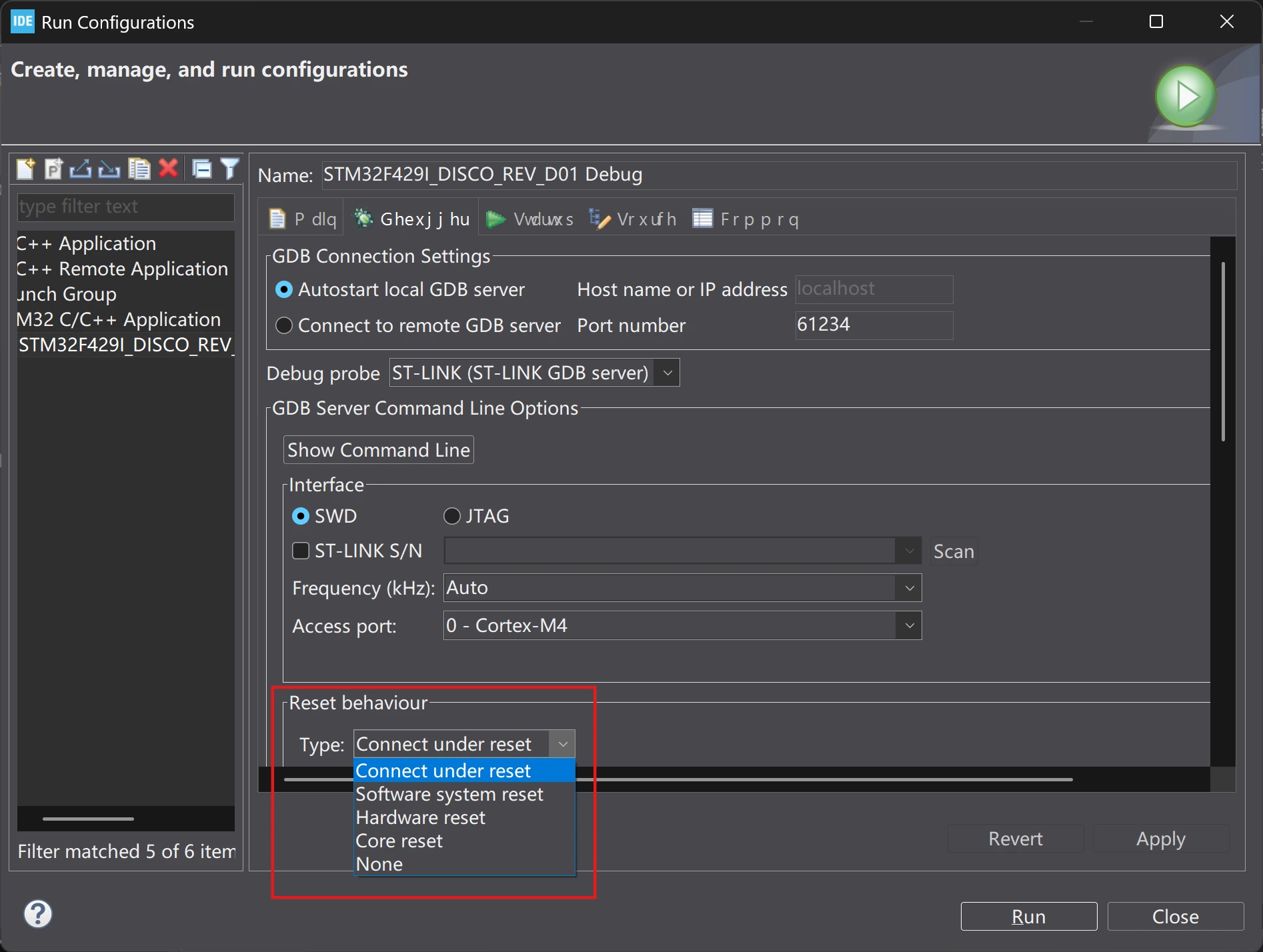

Sep 30, 2026 3:04 AM UTC
The reason is the debugger settings. E.g. in STM32CubeIDE debugger settings if the Reset behavior is Connect under reset (default) MCU will be reset after flash programming, others will result in no reset. So if you select the appreciate option in debugger settings, there should be no need to manually reset after flash programming.
