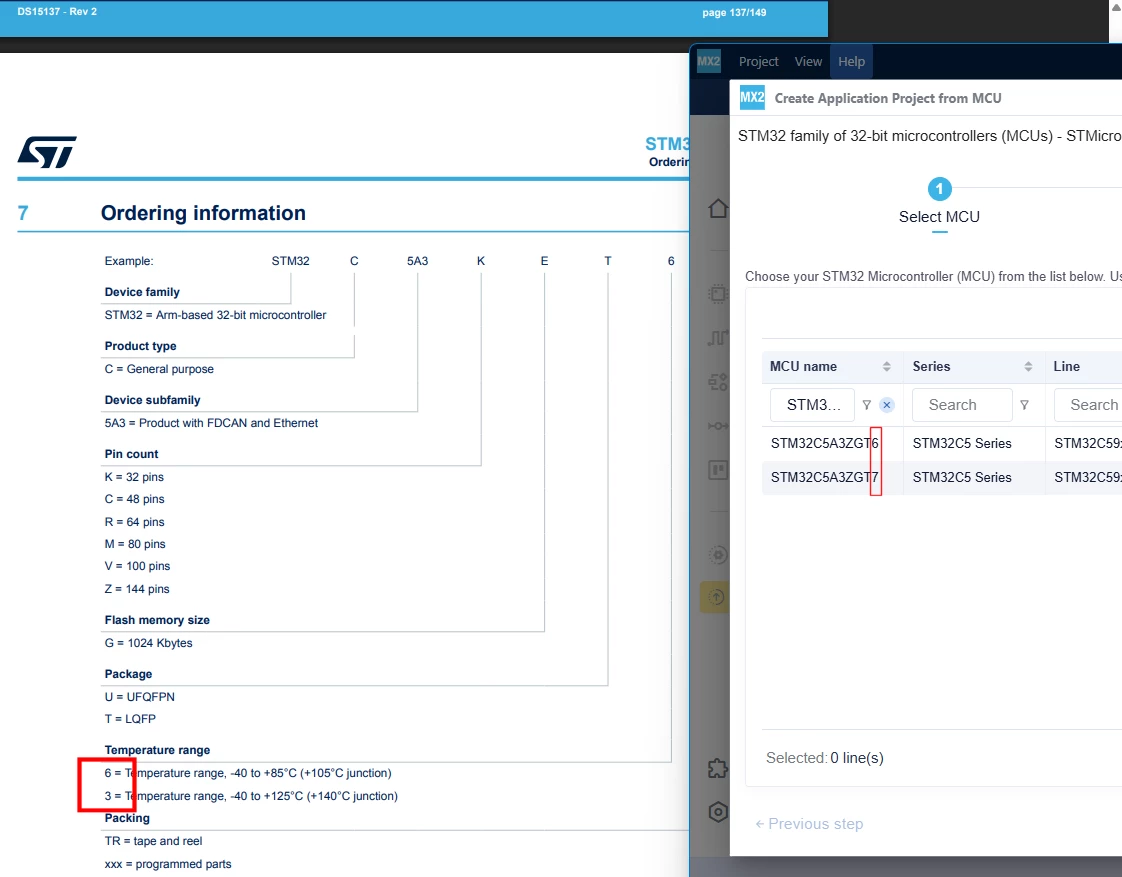

v1.0.1: Offers an unlisted C5A3ZG part number
Searching for “STM32C5A3ZG” (the part number stated on the NUCLEO-C5A3ZG Product Page), CubeMX v1.0.1 offers STM32C5A3ZGT6 and STM32C5A3ZGT7
The latest Datasheet (DS15137, Rev 2) does not list STM32C5A3ZGT7 as a valid ordering code, but it does have STM32C5A3ZGT3 - which is not in the CubeMX2 list:
1 reply

Hello ​@Andrew Neil
Thank you for your feedback.
I have submitted a ticket to review this discrepancy between STM32CubeMX2 and the latest datasheet (DS15137, Rev 2) “ordering codes”. I will get back to you as soon as I have an update.
Internal ticket number: CDM0064174 (This is an internal tracking number and is not accessible or usable by customers).
