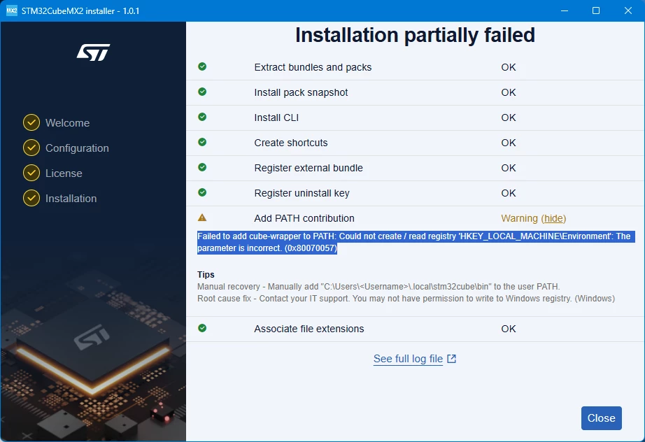

v1.0.1: Failed to add cube-wrapper to PATH
Even when running stm32cubemx2-1.0.1-X64-Windows-installer.exe as Admin:
Failed to add cube-wrapper to PATH: Could not create / read registry 'HKEY_LOCAL_MACHINE\Environment': The parameter is incorrect. (0x80070057)
On Windows 11 Pro
Installing to C:\Program Files\STMicroelectronics\STM32Cube\MX2\1.0.1

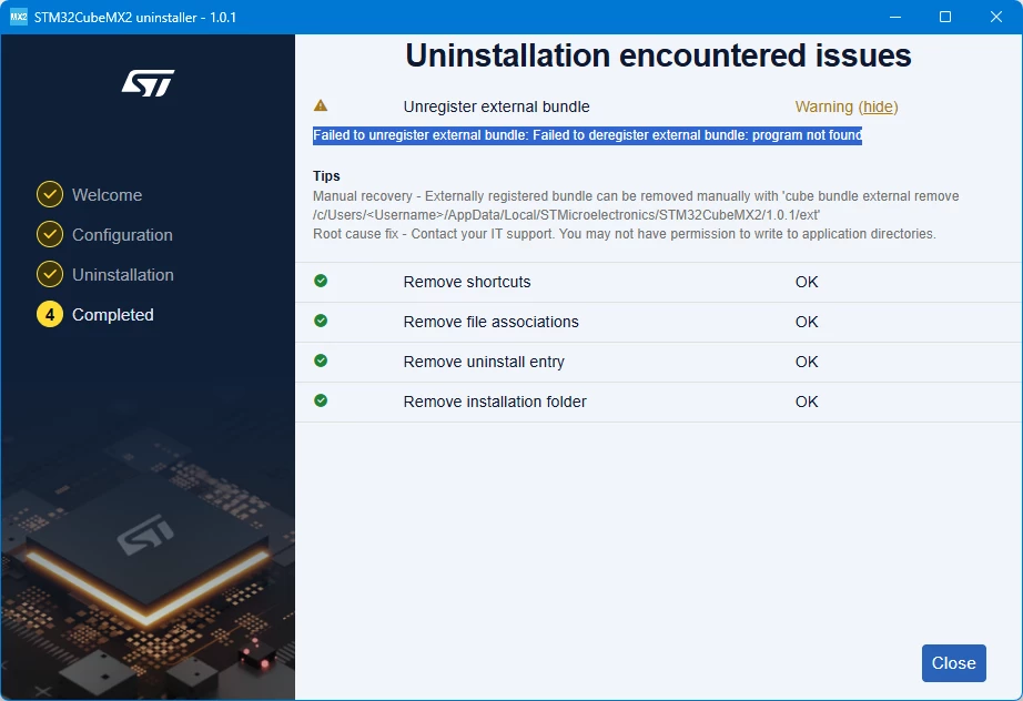

and then, when trying to uninstall it, I get:
Failed to unregister external bundle: Failed to deregister external bundle: program not found
Tips
Manual recovery - Externally registered bundle can be removed manually with 'cube bundle external remove /c/Users/<Username>/AppData/Local/STMicroelectronics/STM32CubeMX2/1.0.1/ext'
Exactly the same issue when installing to the default location:
C:\Users\<user>\AppData\Local\STMicroelectronics\STM32CubeMX2\1.0.1
Sara BEN HADJ YAHYA
Jul 7, 2026 7:07 AM UTC
Hi ​@Andrew Neil ,
Thanks for your feedback.
Usually, this error does not occur when launching in standard mode and is only seen when running as administrator or when there are permission issues,
Admin mode is currently not supported as mentioned in the release notes.
However, you are right that the error is currently occurring in both cases.
As a workaround, please add the cube-wrapper path manually to the user PATH.
The team is working on a fix, which is expected in an upcoming release.
We apologize for any inconvenience caused.
Internal ticket number: CDM0062859 (This is an internal tracking number and is not accessible or usable by customers).
Regards,
Sara.
Sara BEN HADJ YAHYA
Jul 21, 2026 8:05 AM UTC
Hi ​@Andrew Neil
I'm happy to let you know that this issue has been fixed in STM32CubeMX2 release 1.1.0.
Could you please update to this version and check again?
If you still notice any problem after the update, please feel free to let us know and we will be happy to help.
Best regards,
