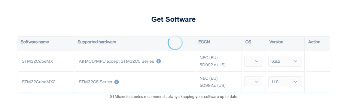

I can’t download it. After logging in it keeps loading forever.

​@hritter Do you have STM32C5 or other new STM32 that requires CubeMX2 and HAL2? For any older MCU just use the familiar Cube1 and libraries, nothing changed from this POV.
