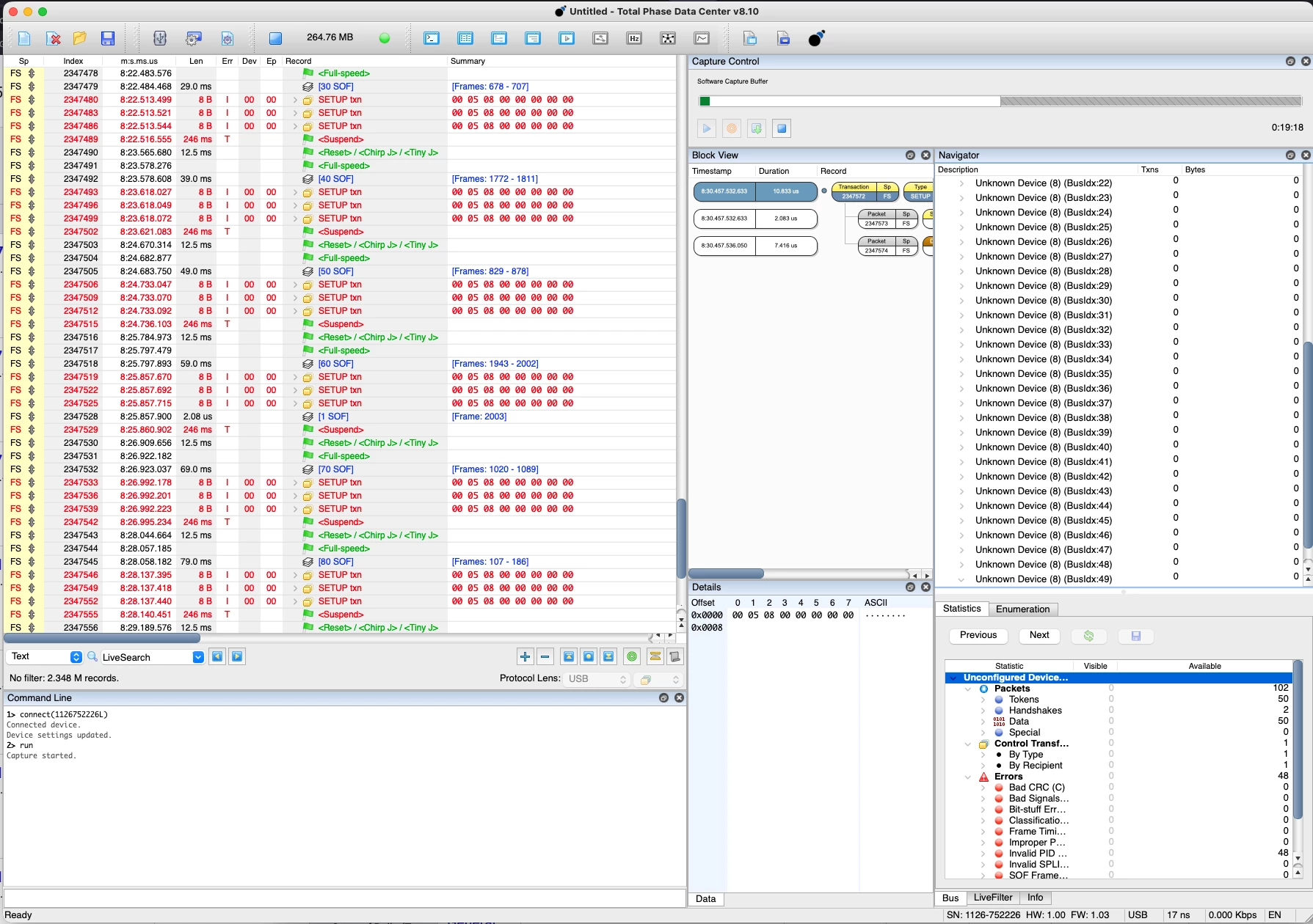

If I look at the USB communication with a Total Phase Beagle USB 480 analyzer, I see nothing (see attachment).
The USB connection is reseted after I press the reset button, then there is a "Full-speed" mark and then the connection is suspended.

The the original example works!!!
I was using a USB-A ↔ USB-C Power-Only cable.
However, the example is still broken after making changes in CubeMX2 and regenerating.
The is some activity on the USB port, but the device is not properly enumerated (see attachment).
I am marking this post as answer, so people can ignore the fist part since I can not edit the post.
