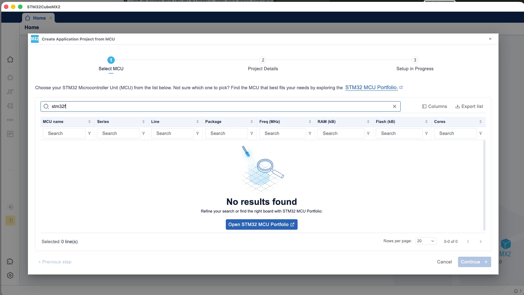

STMCubeMX2 shows only STM32C devices
So I have installed STMCubeMX2 but when creating a project, I cannot choose any MCU other than STM32C
I am using MacOS

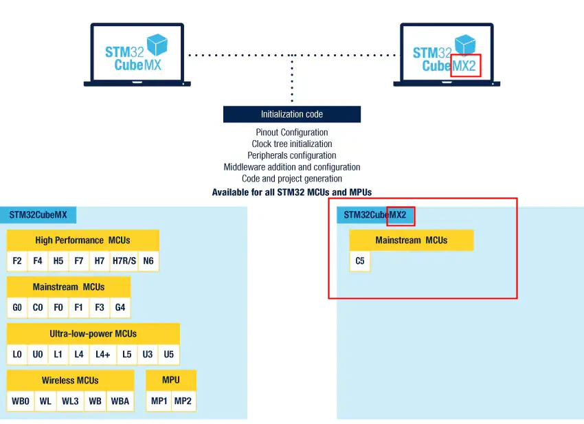

Yes, that is the expected behaviour:
“STM32CubeMX2 is introduced for new STM32 series, starting with STM32C5.”
Older series remain on “original” MX
https://www.st.com/en/development-tools/stm32cubemx.html
