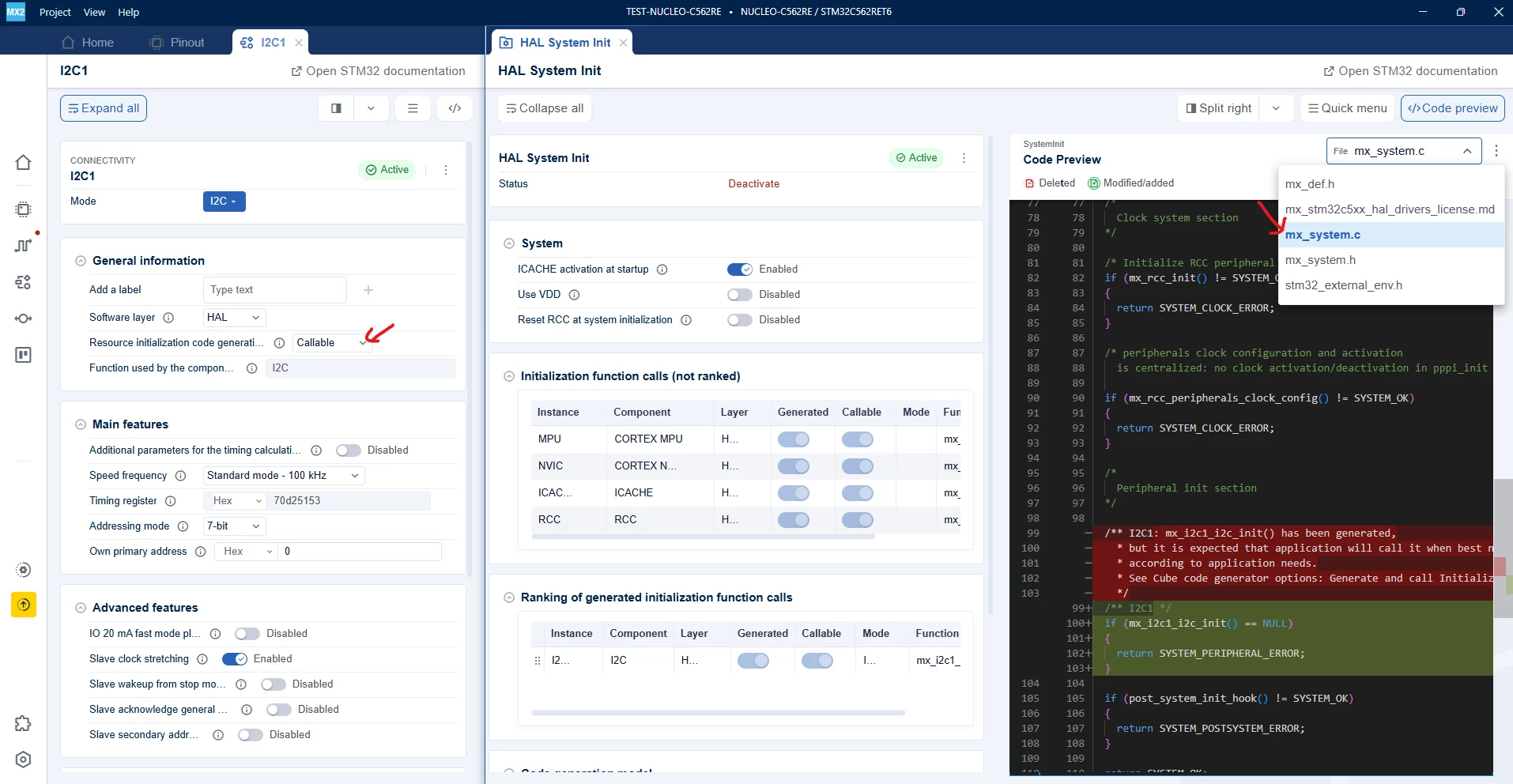

Despite the peripherals are callable, the code preview from STM32CubeMX2 does not call the init functions of the peripherals.
What is the trick to get this done ?
We also see in the HAL common settings, the option to toggle generated vs callable is not selectable.

In STM32CubeMX2, the peripheral init function calls are generated in mx_system.c.
So if you open HAL System Init, you can check the code preview of mx_system.c to see these initialization calls.
The Generated / Callable option cannot be toggled directly from the HAL System Init view. It is managed from the peripheral configuration instead.
For example, in the I2C1 configuration, under General information, you can change the Resource initialization code generation setting. After that, the change will be reflected in mx_system.c.
