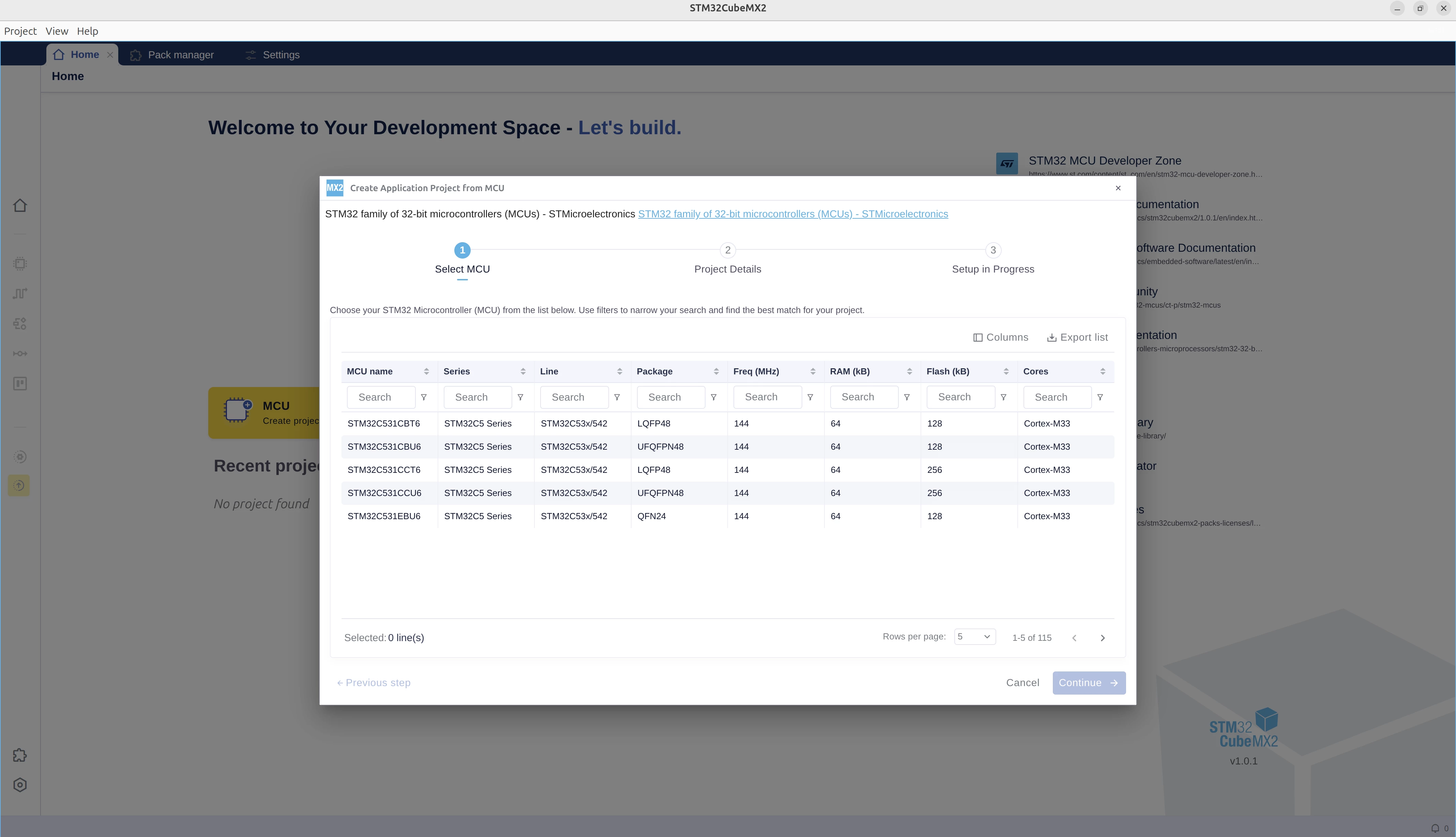

STM32CubeMX2 only has the STM32C5 series. You will need STM32CubeMX to develop on the STM32F4 series. This is intentional.
