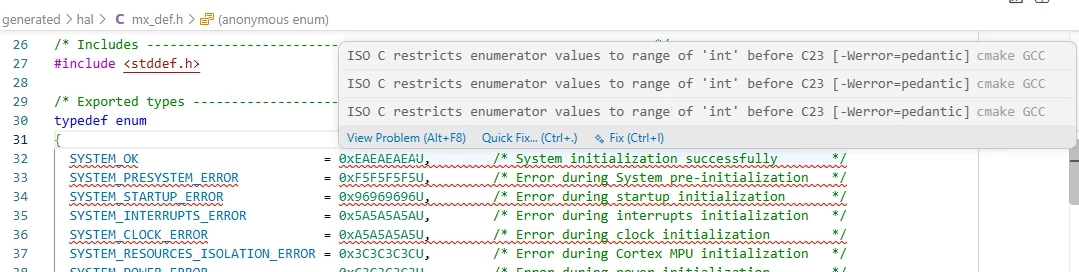

After generating a CMAKE project using STM32CubeMX2 v1.1.1 followed by setting compiler options to “treat warnings as errors” (-Werror) and enable strict standards-conformance (-Wpedantic) in the root CMakeLists.txt file, I am errors in, mx_def.h.
Though this post shows the workaround:
  • What is the recommended C Standard that STM32C5 project should follow?
  • If the generated code stated “gnu11” but yet uses “gnu23”, shouldn’t the generator use the latter instead (see solution)?
  • And, what are the dangers of doing so?
Error Message:
error: ISO C restricts enumerator values to range of 'int' before C23
Full Error message:
[build] C:/PathTo/ProjectName/source/App/generated/hal/mx_def.h:32:38: error: ISO C restricts enumerator values to range of 'int' before C23 [-Werror=pedantic]
[build]    32 |   SYSTEM_OK                        = 0xEAEAEAEAU,        /* System initialization successfully       */
[build]       |                                      ^~~~~~~~~~~
[build] C:/PathTo/ProjectName/source/App/generated/hal/mx_def.h:33:38: error: ISO C restricts enumerator values to range of 'int' before C23 [-Werror=pedantic]
[build]    33 |   SYSTEM_PRESYSTEM_ERROR           = 0xF5F5F5F5U,        /* Error during System pre-initialization   */
[build]       |
Screen Shot:

The Cause of the issue
The generated mx_def.h  enum, system_status_t uses values too large for C11 standard (i.e. greater than signed int), however they are allowed in C23 and GNU23 C Standard.
The Solution
  1. Open your generated file, “cmake/flags.cmake”
  2. Locate the “target_compile_options(“ that defines, “-std=gnu11”
  3. Update this value to “-std=gnu23”
  4. Clean project and recompile.
