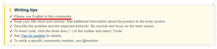

mƎALLEm
Oct 9, 2026 8:32 AM UTC
Hello ​@yun_miao_code ,
Did you read writing tips before posting?
Explorer II
Oct 9, 2026 8:51 AM UTC
This is ST's official technical community, which is primarily for asking and answering questions; it is not intended for sharing development experiences.
Also… this is an English-only forum -_-|||
*This post has been translated from Chinese to comply with the ST Community guidelines.
