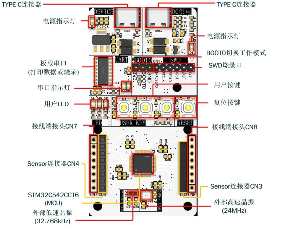

First, prepare a development board. In this tutorial, I use a custom-designed development board. If you are interested in obtaining one, you can apply for a sample.
The main controller is the STM32C542CCT6.

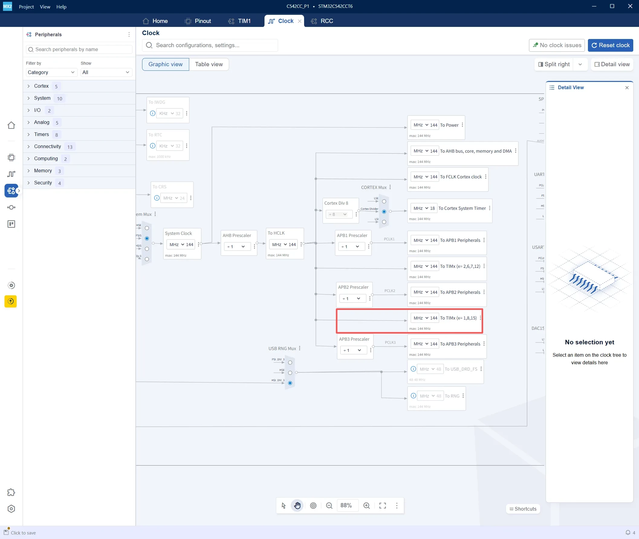

Before configuring the PSC and ARR values of TIM1, first confirm the TIM1 input clock frequency. The PWM frequency calculation depends on the timer input clock; if the clock frequency is determined incorrectly, the resulting PWM frequency will also be inaccurate.
In this example:
TIM1 Clock = 144 MHz
The TIM1 configuration procedure is as follows:

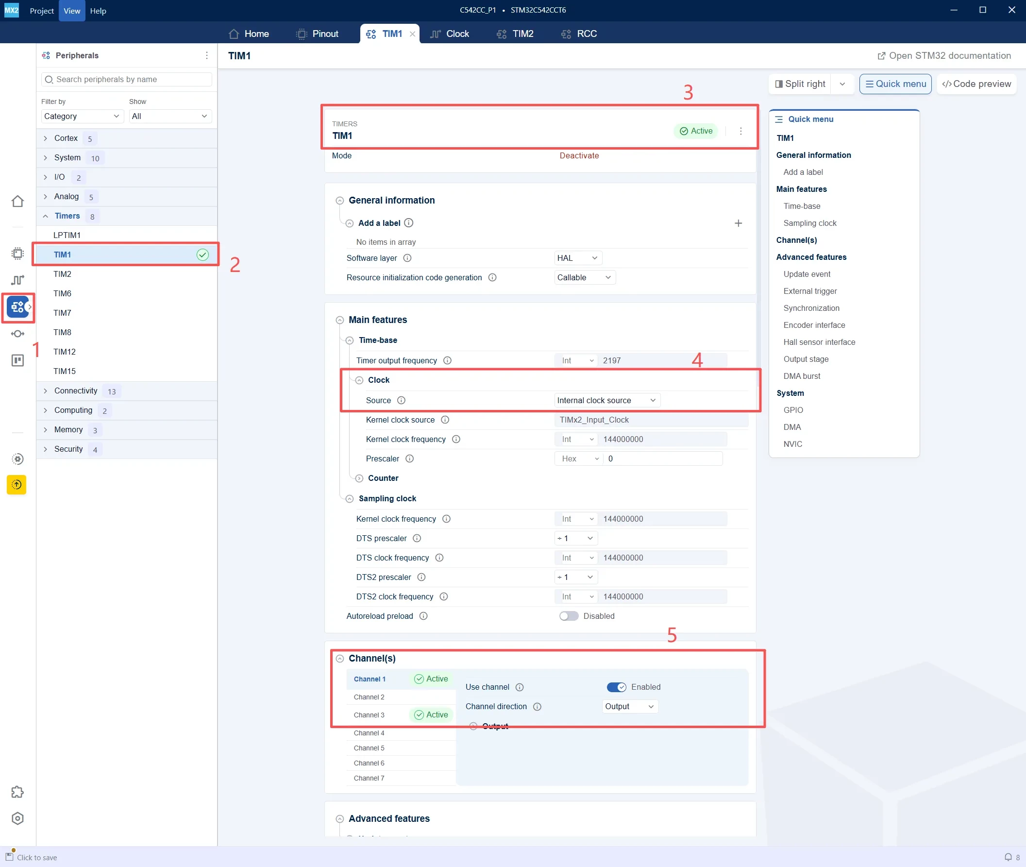

  1. Click Peripherals in the left-side panel to open the peripheral configuration page.
  2. Under the Timers category, select TIM1.
  3. Verify that TIM1 is marked as Active, indicating that the peripheral has been enabled.
  4. Set Clock Source to Internal clock source so that TIM1 uses the internal clock as its counter clock.
  5. Under Channel(s), enable the required output channels, such as Channel 1 and Channel 3.

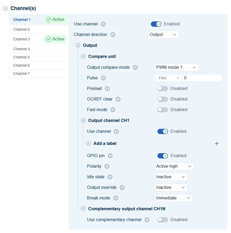

In the Channel(s) configuration section, select Channel 1 and configure it as follows:
  1. Verify that Channel 1 is marked as Active, indicating that TIM1_CH1 has been enabled.
  2. Set Use channel to Enabled.
  3. Set Channel direction to Output so that the channel operates as an output.
  4. Set Output compare mode to PWM mode 1 to generate a PWM waveform.
  5. Set Pulse, which corresponds to CCR1, to configure the PWM duty cycle.
  6. Set GPIO pin to Enabled so that the PWM signal is routed to the corresponding GPIO pin.
  7. Set Polarity to Active high, meaning the PWM active level is high.
  8. Set Idle state to Inactive, meaning the output remains inactive when the channel is idle.
  9. Leave the complementary output channel CH1N set to Disabled, as complementary output is not used in this example.

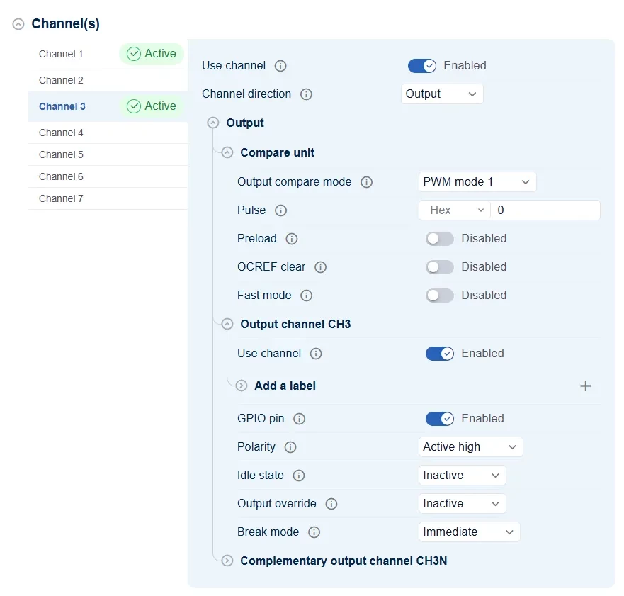

In the Channel(s) configuration section, select Channel 3 and configure it as follows:
  1. Verify that Channel 3 is marked as Active, indicating that TIM1_CH3 has been enabled.
  5. Set Pulse, which corresponds to CCR3, to configure the duty cycle of TIM1_CH3.
  9. The complementary output channel CH3N is not used. This example uses only the standard PWM output.

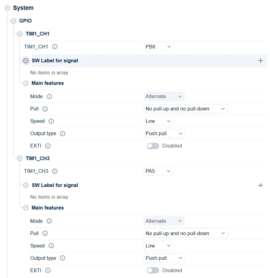

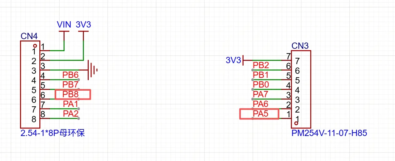

The current pin assignment is as follows:
  • TIM1_CH1 → PB8
  • TIM1_CH3 → PA5
Therefore, TIM1_CH1 is routed to PB8, while TIM1_CH3 is routed to PA5.
The GPIO configuration for both pins is essentially the same:
  • Mode: Alternate
  • Pull: No pull-up and no pull-down
  • Speed: Low
  • Output type: Push-pull
  • EXTI: Disabled

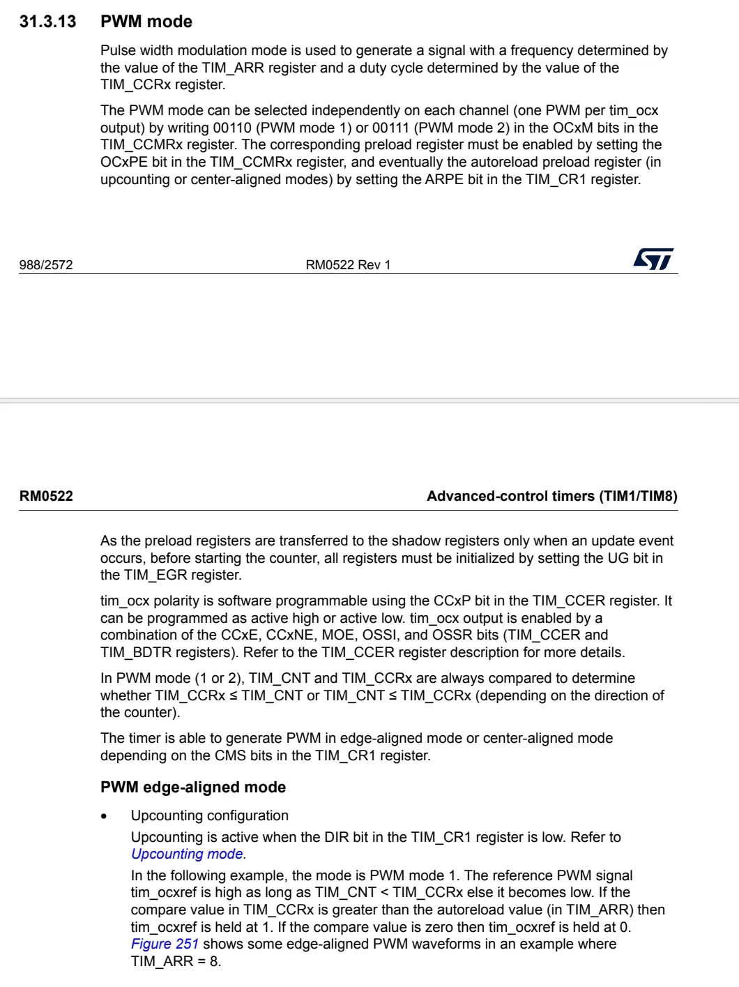

How PWM Mode Works
According to the PWM mode section in RM0522, PWM mode is used to generate a periodic output signal. The signal frequency is determined by the TIM_ARR auto-reload register, while the duty cycle is determined by the TIM_CCRx capture/compare register.
The reference manual also states that PWM mode can be selected independently for each channel. This means that a single TIM peripheral can provide multiple PWM output channels, for example:
  • TIM1_CH1
  • TIM1_CH2
  • TIM1_CH3
  • TIM1_CH4
Each channel can be configured independently as PWM mode 1 or PWM mode 2. This tutorial uses PWM mode 1.
In up-counting mode, PWM mode 1 can be understood as follows:
  • When TIM_CNT < TIM_CCRx, the PWM output is at the active level.
  • When TIM_CNT >= TIM_CCRx, the PWM output is at the inactive level.
Because the PWM output polarity was previously configured as Active high in STM32CubeMX2, the active level is a high level in this example.
Therefore, within one PWM period, increasing the value of TIM_CCRx extends the high-level duration and increases the duty cycle.

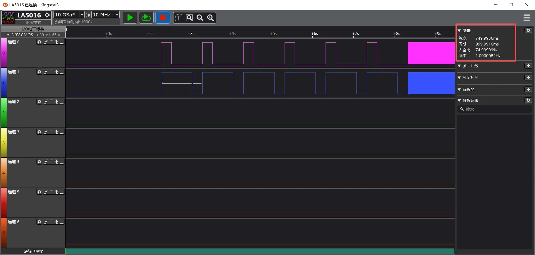

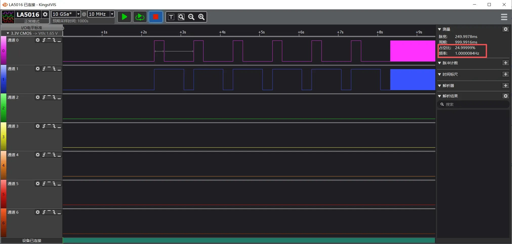

This experiment is based on the STM32C542CCT6 and uses STM32CubeMX2 to configure the TIM1 PWM output.
Two TIM1 output channels are used:
TIM1_CH1 -> PB8
TIM1_CH3 -> PA5
Both TIM1_CH1 and TIM1_CH3 are configured in PWM mode 1. The PWM frequency and duty cycle are dynamically adjusted using the built-in HAL2 functions.
The following header files are used in the code:
#include <stdio.h>
#include "mx_tim1.h"
The TIM1 input clock is defined as 144 MHz. Therefore, 144 MHz is used as the input clock for the subsequent PWM frequency calculations.
To generate a 1000 Hz PWM signal, it is recommended to set ARR to 999.
In this configuration, one PWM period contains:
ARR + 1 = 999 + 1 = 1000
counter ticks, which makes the duty-cycle calculation easier.
The PWM frequency is calculated using the following formula:
PWM Frequency = TIM1_CLK / ((PSC + 1) × (ARR + 1))
When:
TIM1_CLK = 144 MHz
PSC = 143
ARR = 999
the PWM frequency is calculated as follows:
PWM Frequency = 144,000,000 / ((143 + 1) × (999 + 1))
= 144,000,000 / (144 × 1000)
= 1000 Hz

* TIM1_CH1 -> PB8
* TIM1_CH3 -> PA5

* TIM1_CLK = 144 MHz
* ARR = 9999
* 设置 PWM 频率为 1Hz
* PWM频率 = 144MHz / ((PSC + 1) * (ARR + 1))
* ARR = 9999
* 当 freq = 1Hz 时,PSC = 14399

Demonstration

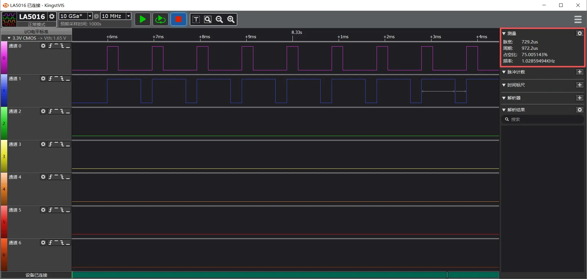

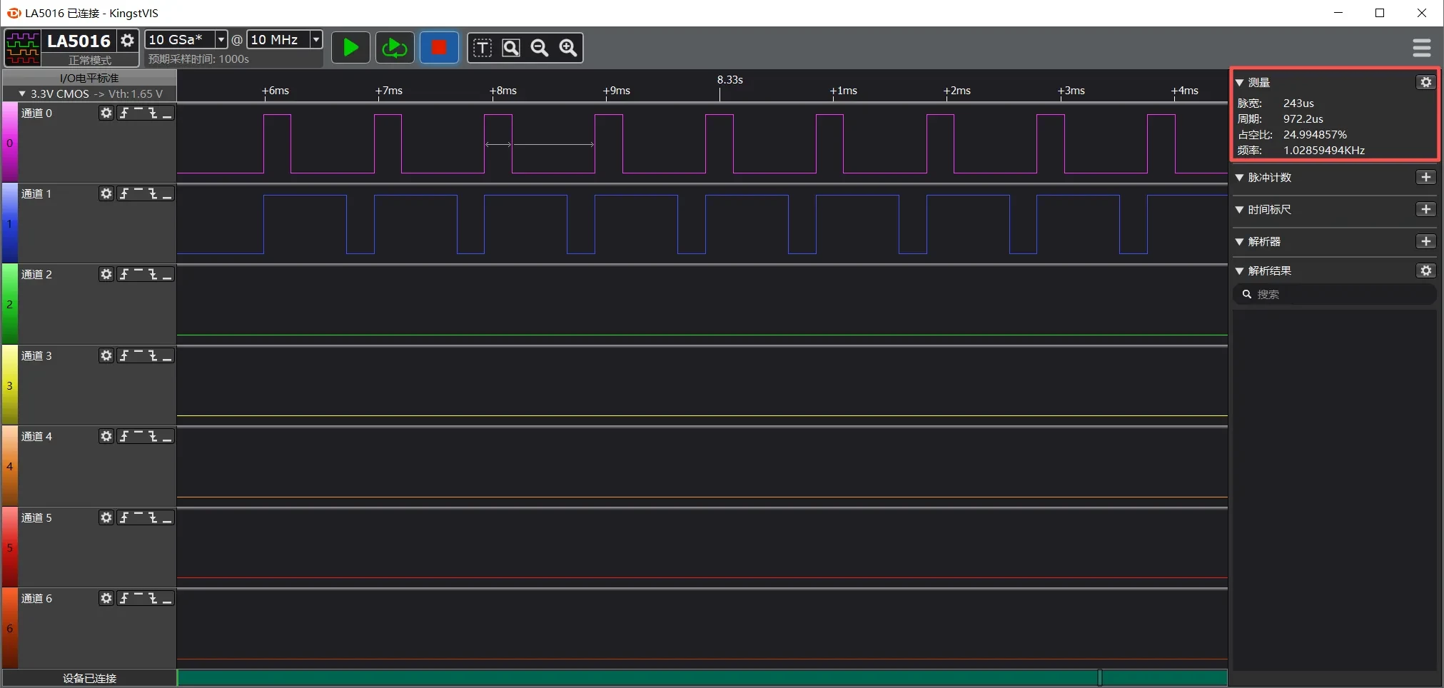

Use an oscilloscope or logic analyzer to measure the PWM signals on PB8 and PA5.
The two PWM channels have the same output frequency. Initially, the following PWM signals are generated:
TIM1_CH1: 1 Hz, 25% duty cycle
TIM1_CH3: 1 Hz, 75% duty cycle
The output is then changed to two 1 kHz PWM signals:
TIM1_CH1: 1 kHz, 25% duty cycle
TIM1_CH3: 1 kHz, 75% duty cycle
