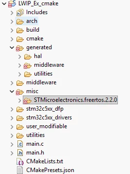

I'm trying to develop an application with LwIP without an operating system using the STM32C5A3x.
When I set the LwIP operating system to “No OS,” I see some files in the CMake project that call FreeRTOSConfig.h, and the compilation fails.
Is anyone else experiencing the same problem?

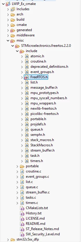

When I try to compile the project using STM32CubeIDE, without making any changes, I get this error:
STM32C5_workspace/LWIP_EX/LWIP_Ex_cmake/misc/STMicroelectronics.freertos.2.2.0/include/FreeRTOS.h:58:10: fatal error: FreeRTOSConfig.h: No such file or directory
58 | #include “FreeRTOSConfig.h”
In the project tree, there is a folder named misc/STMicroelectronics.freertos.2.2.0.
I may be wrong, but I believe this folder should not have been created by CubeMX2, since LwIP is configured without FreeRTOS.
