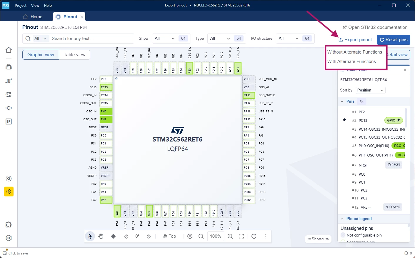

I've just installed CubeMX2 to start work on a new project using STM32C552xxx.
My normal practice is to export a .csv of all the processor pins along with the alternate functions and in CubeMX this is easy.
But Cube MX2 only exports a .csv like this:
Position Pin Type Signals Pin labels
1 PE2 gpio
2 PC13 gpio
3 PC14-OSC32_IN(OSC32_IN) gpio
Please tell me there is an option to list all the alternate functions in the.csv.
It is quite impossible to to allocate the pins and peripherals for a new design working only with the pop_up detail view in CubeMX2.
An acceptable alternative would be for ST to just publish such a .csv some where.

Hello
Thank you for your feedback.
In STM32CubeMX2 version 1.1.1, the pinout can be exported in CSV format either without alternate functions or with alternate functions.
CubeMX can do this - so MX2 absolutely needs to do it, too!
