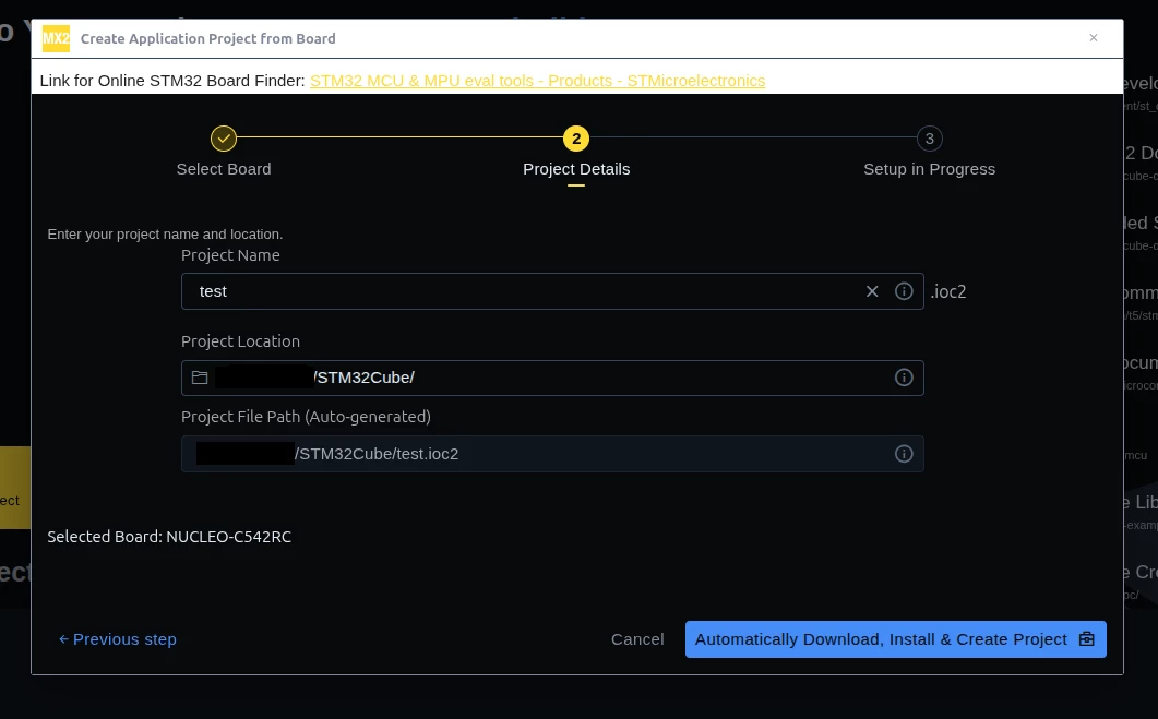

I am currently facing a strange error when trying to create a project with any MCU/Board on Linux.

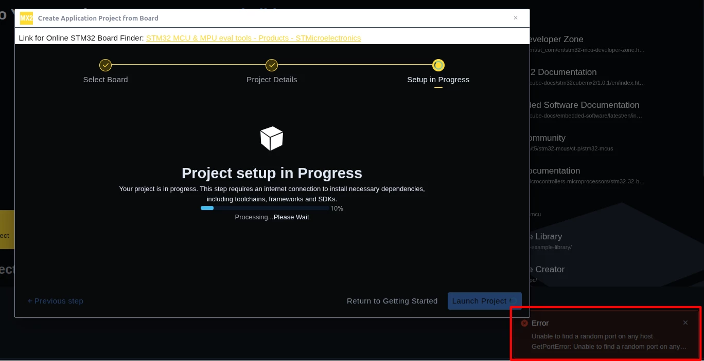

As shown on the screenshots, an error appears on dependencies download :
Unable to find a random port on any host GetPortError:
Unable to find a random port on any ...
And it spin indefinitly.
This error seems to be related to Electron rather than the soft itself, but I can hardly follow the execution path of stm32CubeMX2 to know where I could maybe enforce another port.
Did anyone already encountered this bug ?
Thanks.

Hi oussama,
You can find attached my log file.
The important lines are:
2026-05-26T09:14:42.209Z [Debug] [ProjectSetupWidget#handleValidation] Creating application project from Board
2026-05-26T09:14:42.211Z [Debug] [ProjectCreationComponent#getProjectCreationForm] Render get project creation form
2026-05-26T09:14:42.328Z [Error] Uncaught Exception: GetPortError: Unable to find a random port on any host
2026-05-26T09:14:42.328Z [Error] GetPortError: Unable to find a random port on any host
at S (/scratch/softs/STM32CubeMX2/resources/stm32cubemx-application/1.0.1/dist/resources/app/lib/backend/main.js:2903:8475)
at async /scratch/softs/STM32CubeMX2/resources/stm32cubemx-application/1.0.1/dist/resources/app/lib/backend/main.js:356:222566
at async r (/scratch/softs/STM32CubeMX2/resources/stm32cubemx-application/1.0.1/dist/resources/app/lib/backend/main.js:431:285270)
at async b.dynamicValue (/scratch/softs/STM32CubeMX2/resources/stm32cubemx-application/1.0.1/dist/resources/app/lib/backend/main.js:431:285528)
Thanks for your interest.
Laurent.

Oussama_TROUDI
Aug 22, 2026 5:09 PM UTC
Hello
Please try the following workaround by adding the host name to /etc/hosts.
  1. Open a terminal.
  2. Edit the file with root privileges:   sudo nano /etc/hosts
  3. dd or update this line:  127.0.0.1 localhost
  4. Save the file and exit.
Please let me know whether this works for you.
Regards
Oussama

Hello Oussama,
I have tried both removing and commenting this line (127.0.0.1 localhost), but it didn't change anything.
However, thanks to your suggestion about /etc/hosts and this issue nuxt issue 19068, I figured out that my $HOST variable was set to :
HOST=MyPrecious
Thus, it tried to find a port for MyPrecious, which is not a valid host !
Thus adding it to /etc/hosts with a given IP:
127.0.0.1 localhost 127.0.2.1 MyPrecious
Solved the problem !!! Thus, you should make sure that if $HOST is defined, it HAS TO BE GIVEN an IP in /etc/hosts.
Thus, my problem is solved.
I hope that it will help others !
Thank you Oussama for your time,
Laurent.
