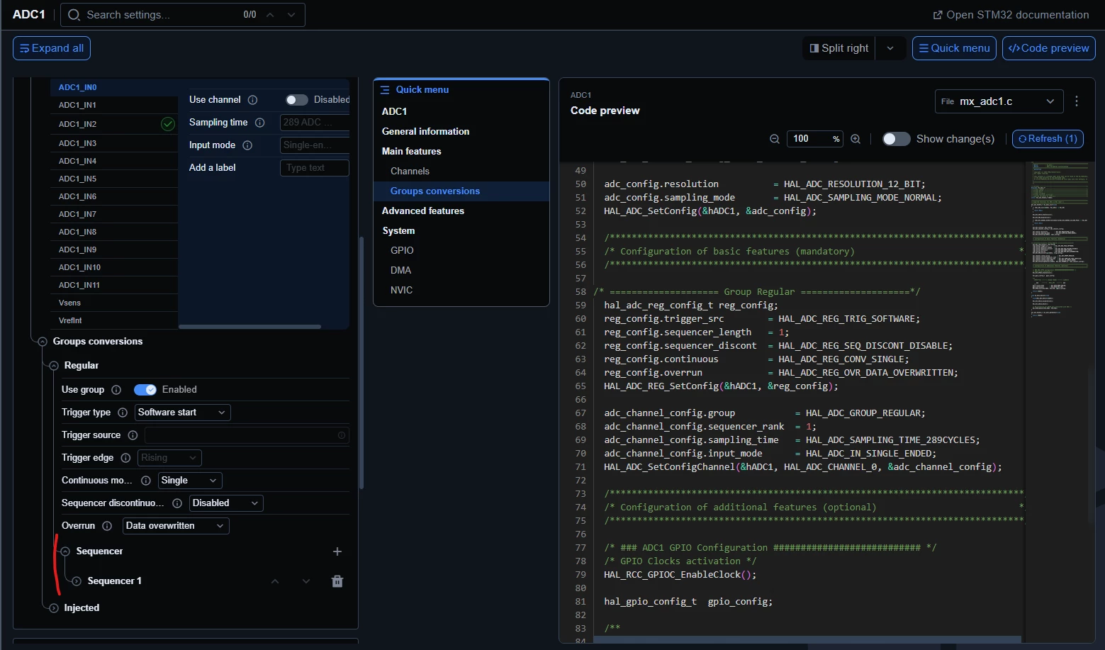

Summary:
On STM32C5, four ADC1 external channels (IN2, IN5, IN6, IN7) have an alternate GPIO pad selectable via the SBS_PMCR pin-remap bits (ADC1_IN2_REMAP -> PC4, IN5_REMAP -> PC5, IN6_REMAP -> PB0, IN7_REMAP -> PB1 on STM32C542). CubeMX2's pin configurator lets you assign the remapped pad in the graphical pinout, accepts it, and generates both the GPIO analog-mode config for that pad and the ADC channel/sequencer configuration for the channel. However, it never emits the corresponding SBS_PMCR remap-enable write. The generated firmware therefore samples the default (non-remapped) pad, while the pin the schematic actually uses is left unread.
There is no generation warning, no build error, and no runtime fault. The ADC returns a stable, plausible, but wrong 12-bit code.
Reproduction:
1. Assign ADC1_IN7 to PB1 in the CubeMX2 pinout (the UI only permits IN7 for PB1).
2. Generate the project.
3. Result: mx_adc1.c contains the channel-7 config and the comment "PB1 ------> ADC1_IN7 ------> “pin_label", and PB1 is configured as analog. No SBS_PMCR / ADC1_IN7_REMAP write is emitted anywhere in generated/.
4. Grepping the entire generated/ tree for PMCR, IN7_REMAP, or EnableADCChannelPinRemap returns nothing.
We confirmed the SBS remap is the root cause on hardware: adding a manual SBS_PMCR.ADC1_IN7_REMAP write (after enabling the SBS clock) before the first conversion makes the channel read PB1 correctly.
Enabling the SBS peripheral component in CubeMX2 does not fix this: after regeneration CubeMX2 emits mx_sbs.c/.h and the HAL_RCC_SBS_EnableClock() plumbing, but still does not generate the SBS_PMCR.ADC1_IN7_REMAP write. The bug persists unchanged whether SBS is enabled or disabled.

3. The ADC PCSEL register is never configured by generated code. HAL_ADC_SetConfigChannel() is emitted commented-out in mx_adc1_init() ("information missing in CubeMX2 interface"), so the per-conversion call at the application level runs after ADEN=1, when PCSEL is no longer writable and the write is silently dropped. This is a separate config-generation gap worth closing at the same time.

Aug 13, 2026 12:41 PM UTC
Hello ​@stonestone ,
To address your first and second points, the issue has been validated, and an internal ticket has been opened under reference: CDM0065087. (Please note that this is an internal tracking number and is not accessible or usable by customers)
Now, to address your third point: when Group conversions is enabled, CubeMX2 replaces the commented ADC channel stub with a generated HAL_ADC_SetConfigChannel() block. The issue is not that the call is missing entirely, but that the codegen path changes with Group conversions and must still ensure the required ADC channel setup is emitted correctly and at the right time.
