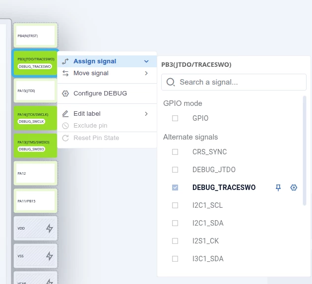

CubeMX2, allow to use SWD without SWO
when you enable SWD in CubeMX2 it automatically blocks the SWO pin as well (tested using C531FBP6), but I only need SWCLK / SWDIO to debug. please add a way to disable the use of SWO.

Karl Yamashita
Mar 26, 2026 7:49 PM UTC
You can right click and reset the pin state so it's no longer SWO.

av500
av500Author
Mar 26, 2026 9:20 PM UTC
sorry, but I cannot, as you can see, "Reset Pin State" is disabled
Karl Yamashita
Mar 26, 2026 9:24 PM UTC
Must be a bug on your selected part. I was able to do it on the C562RE

Karl Yamashita
Mar 26, 2026 10:35 PM UTC
It looks like if I select as a Board project with the C562RE, i am able to reset the SWD pins.
If i create as an MCU project with C562RE, I can't reset the pins.

av500
av500Author
Mar 26, 2026 10:47 PM UTC
yes, when you open the C652 NUCLEO board, the 3 SWD pins are reserved and can be reset, but once debug is configured, you cannot reset any of them...
Karl Yamashita
Mar 26, 2026 11:16 PM UTC
@av500 @Oussama_TROUDI
I see now, I didn't Activate the SWD. Because it was highlighted and labeled when the project was opened, I assumed it was enabled. I didn't look at the legend.

Mar 30, 2026 1:34 PM UTC
Hello @av500
Thank you for bringing this issue to our attention.
I reported this internally.
Internal ticket number: CDM0061153

Saket_OmBest answer
Jun 25, 2026 8:50 AM UTC
Hello ​@av500
The issue has been solved in the new STM32C5 Ecosystem release 2.1.0.
