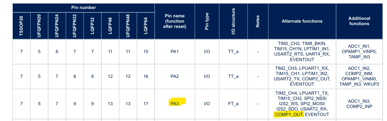

Many thanks for your reply trying to help me with Pins Assignment for the Comparator Inputs, but, You only confirmed what I mentioned in my original post!
Namely, let me remind that I plan to use Comparator2 in such way :
PA7 pin as Comparator2 Output
and pin PA2 as Comparator2 -INPut,
and pin PA3 as Comparator2 +INPut.
In short,
it is not a problem to "assign" Comparator Output, COMP2_OUT to pin PA7, since I will declare AF14 = COMP2_OUT in appropriate GPIOA_AFRL register, see page 352 in RM0522 Reference manual, (RM)
but,
how to assign Comparator Inputs mentioned in “Additional Functions” in rightmost column in Table 12 in DS ?
In other words, how to assign, for example, pin PA2 to Comparator2 INPUT Minus ?
Is there some Register to do so ?
or the only way is to do that “assignment” in Software using CubeMX2 tool ?
(I did not find such statements in Code Examples you pointed...)
Best regards,
Blazi

Hello ​@blaziBUCK
The Additional functions are usually analog connections. The GPIO pin is configured in analog mode, and the peripheral’s own register selects the connection.
For STM32C542, the detailed mapping is:
PA2 = COMP2_INM3   -> COMP2 negative input, IO3
PA3 = COMP2_INP1 -> COMP2 positive input, IO1
The datasheet table may show COMP2_INP and COMP2_INM without the selector number.
Manual configuration example :
/* 1. Enable GPIOA and COMP1/COMP2 clocks */
RCC->AHB2ENR |= RCC_AHB2ENR_GPIOAEN;
RCC->APB1HENR |= RCC_APB1HENR_COMP12EN;
/* 2. Configure PA2 and PA3 as analog inputs */
GPIOA->MODER &= ~((3UL << 4U) | (3UL << 6U));
GPIOA->MODER |= ((3UL << 4U) | (3UL << 6U));
GPIOA->PUPDR &= ~((3UL << 4U) | (3UL << 6U));
/* 3. Select comparator inputs in COMP2_CFGR1 */
/* PA3 = COMP2_INP1 = positive input IO1 */
COMP2->CFGR1 &= ~COMP_CFGR1_INPSEL;
/* PA2 = COMP2_INM3 = negative input IO3 */
COMP2->CFGR1 &= ~COMP_CFGR1_INMSEL;
COMP2->CFGR1 |= (7UL << COMP_CFGR1_INMSEL_Pos);
/* 4. Enable COMP2 */
COMP2->CFGR1 |= COMP_CFGR1_EN;
Registers used from RM0522
RCC_AHB2ENR.GPIOAEN :      Enable GPIOA clock
RCC_APB1HENR.COMP12EN :   Enable COMP1/COMP2 clock
GPIOA_MODER.MODE2:       PA2 analog mode
GPIOA_MODER.MODE3:       PA3 analog mode
COMP2_CFGR1.INMSEL  :     Select negative comparator input
COMP2_CFGR1.INPSEL  :     Select positive comparator input
COMP2_CFGR1.EN      :     Enable COMP2
Thus, PA2 is assigned to the COMP2 negative input through:
COMP2_CFGR1.INMSEL = IO3
and PA3 is assigned to the COMP2 positive input through:
COMP2_CFGR1.INPSEL = IO1
