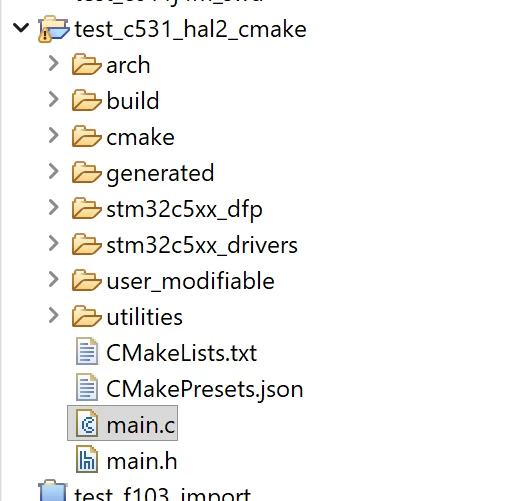

TDKAuthor
Mar 17, 2026 11:25 PM UTC
@Nawres GHARBI
This post is me encountering issues and asking for assistance.
Is there a workflow? The "File -> Import -> Existing Projects..." option imports a project but there is no "build" option.

Oussama_TROUDI
Oussama_TROUDIBest answer
Mar 18, 2026 1:18 AM UTC
Hello  @TDK ,
This is the recommended way to use an STM32CubeMX2 CMake project with STM32CubeIDE (v2.1.1 recommended):
  • In STM32CubeIDE, go to File → STM32 Project Create/Import.
  • Under Import STM32 Project, select STM32 CMake Project, then click Next.
  • Enter a project name and select the source folder, then click Next.
  • Choose the correct STM32 MCU and click Finish.
The project will then appear as an STM32 CMake project, and the normal Build option will be available.
