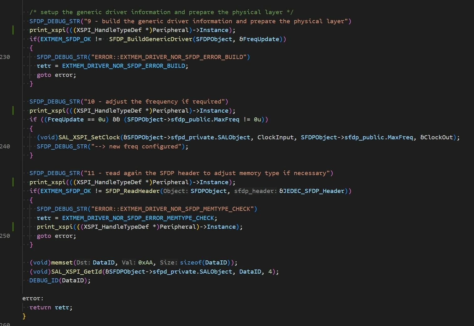

Thanks for the reply.
I have added the EXTMEMSALXSPIDEBUGLEVEL macro and printed the registers for XSPI2 in steps 9, 10 and 11
The location of the print is shown below.
The log as follow:

Hello @totoro ,
Thanks for the dump of registers!
On the second reading of the SFDP signature (step 11), we can see that the memory has been configured in 1S8S8S mode.
By checking the XSPI register, we found the following:
  • IR => 0x5A (Read SFDP command)
  • AR => 0x0 (Address)
  • CCR => 0x04003401
    • DMODE = 1 => Data on one line
    • ADSIZE = 3 => 32-bit address
    • ADMODE = 4 => Address on eight lines
    • ISIZE = 0 => 8-bit instruction
    • IMODE = 1 => Instruction on one line
  • DTR is disabled for Instruction, Address, and Data
  • TCR = 8 => 8 dummy cycles
According to the memory datasheet, the READ SFDP command is only described for standard SPI and octal DDR modes.
Could you try modifying the following line in the function
SAL_XSPI_GetSFDP(SAL_XSPI_ObjectTypeDef *SalXspi, uint32_t Address, uint8_t *Data, uint32_t DataSize)
if (s_command.AddressMode == HAL_XSPI_ADDRESS_1_LINE)
to
 if ((s_command.AddressMode == HAL_XSPI_ADDRESS_1_LINE) || (s_command.AddressMode == HAL_XSPI_ADDRESS_8_LINES))
Kind regards,
