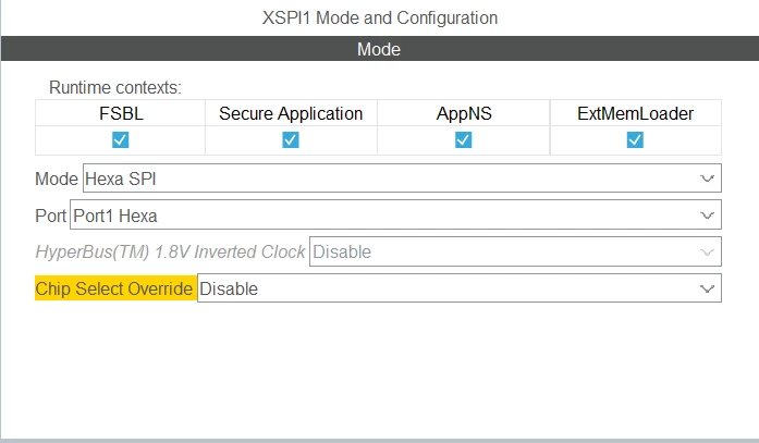

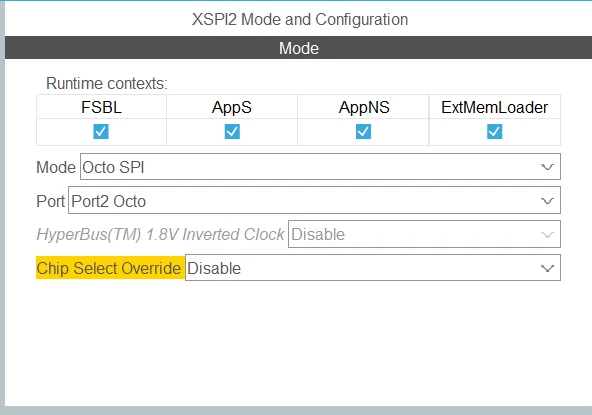

I am using STM32N657X0H3Q,
I am trying to interface unused XSPIM_1 pin - PO1 and XSPIM_2 pin - PN12 as i/o pins,
However, STM32CubeMX flags “PARTLY DISABLES CONFLICT” when I try to use them as i/o pins.
Can I still continue to use them as GPIO, as I need to interface them with my flash, which works at 1.8v,
but my VDD=3.3V, so I only have my freedom of pins left in XSPI_1 and XSPI_2(both of them powered by VDDIO2 AND VDDIO3 are connected to same source at 1.8v), so the pins left are PO1,PO5, AND PN12,
It does not raise an issue when I use PO5; it raises an issue for both PN12 and PO1,
Can Someone please help me sort this? Can I still use them, or do I necessarily have to go with a level shifter
Thank you.

1)This is what i could see if i set PN12 as GPIO OUTPUT: CHIP SELECT OVERRIDE error in  XSPI2
2)This is what I could see when I select PO1 as GPIO OUTPUT: CHIP SELECT OVERRIDE error in  XSPI1
For this, I have attached my IOC file with the pin configuration, However in the attached document i have not enabled PN12 and PO1 to be GPIO, please let me know if i can ignore the warnings and use it as GPIO.
Please check and let me know.
