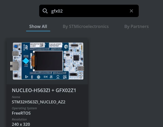

May 18, 2024
I mean 723 that report @guc , but in latest TouchFX i see this , then export code and learn from project folder.
