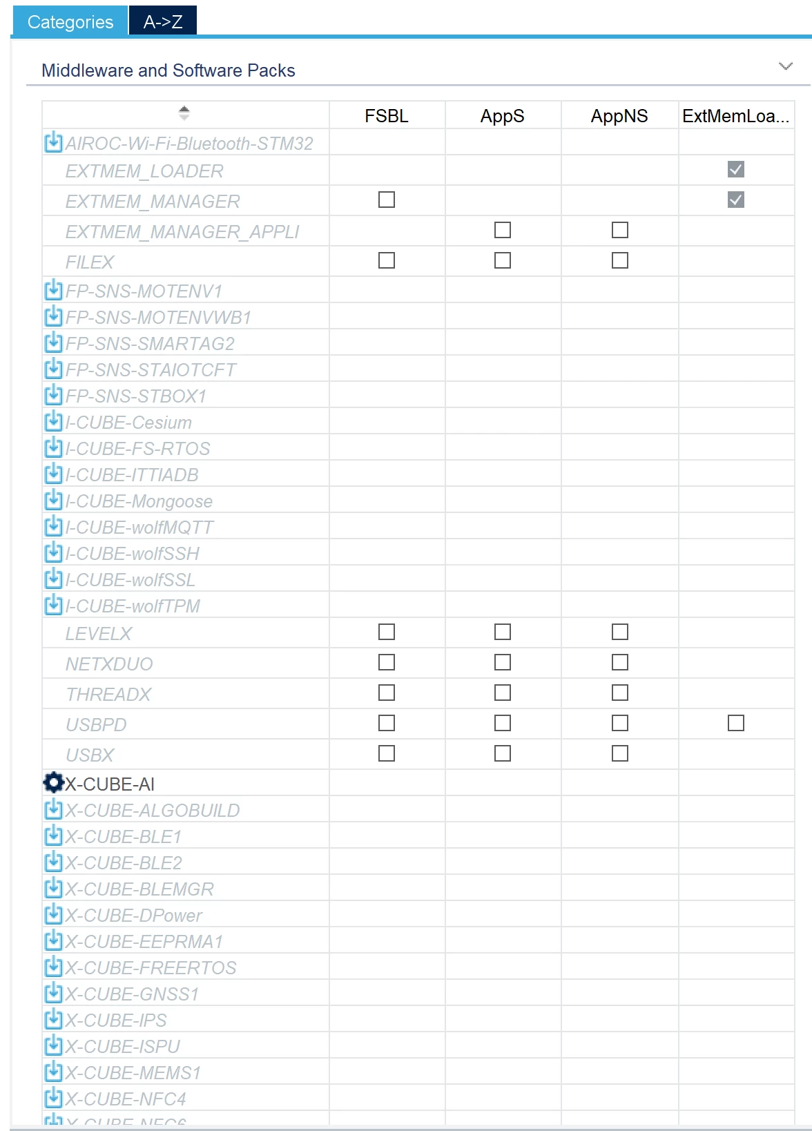

I'm using STM32CubeMX for STM32N657x0HxQ controller. I would like to use ST ISP Library to handle MB1854 camera module. But I could not find the X-CUBE-ISP in STM32CubeMX Pinout & Configuration page, which is as follows.

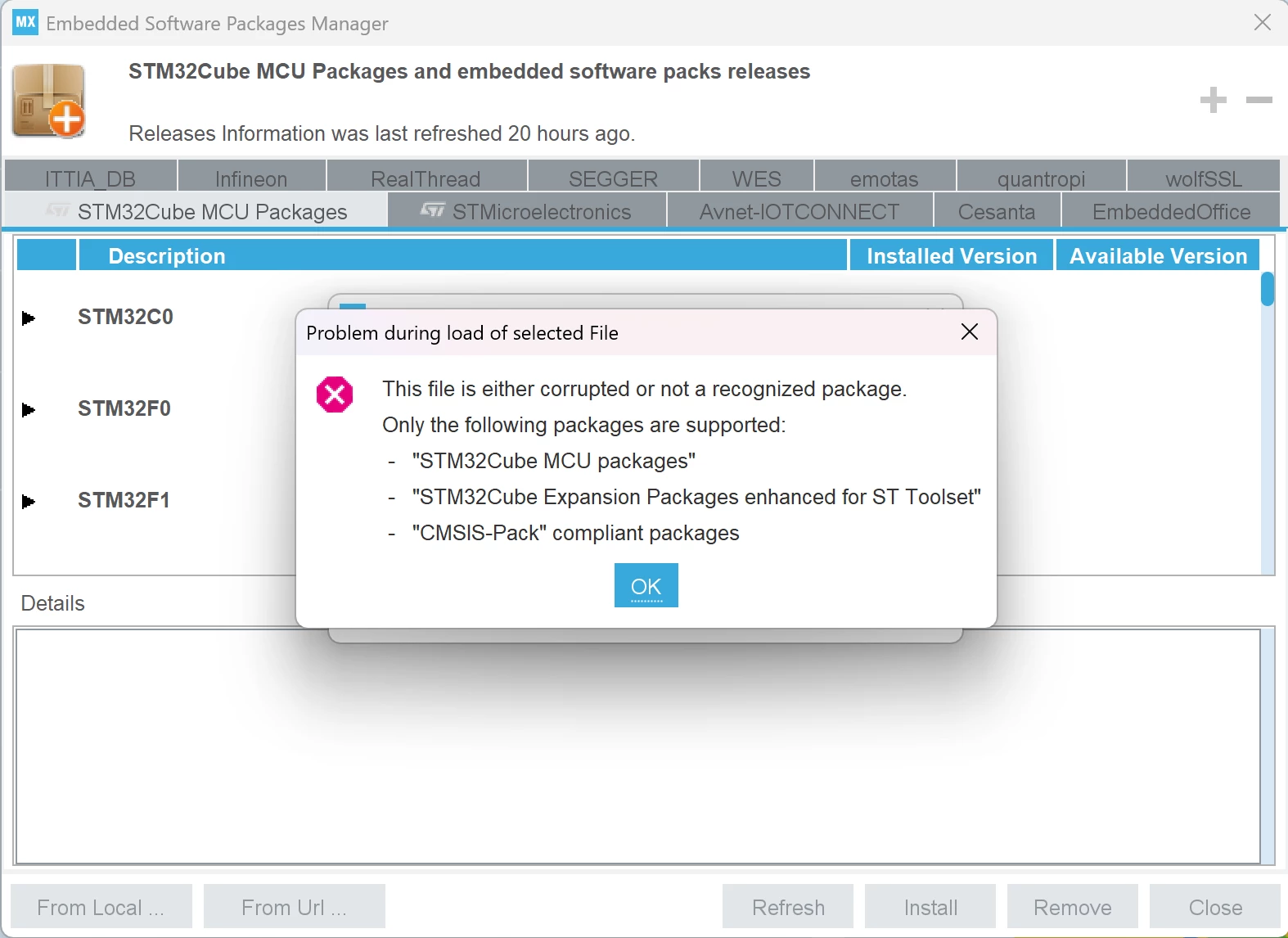

So I tried to import x-cube-isp.zip file downloaded from GitHub. But I came across the following error message.
My STM32CubeMX version is Version 6.16.1 for Windows 11.

Hello @JaeLee
Thanks for posting!
Actually, X-CUBE-ISP is not supported with STM32CubeMX. You have the option to use it with STM32CubeIDE as stated on ISP:Getting started with X-CUBE-ISP - stm32mcu.
KR, Souhaib
