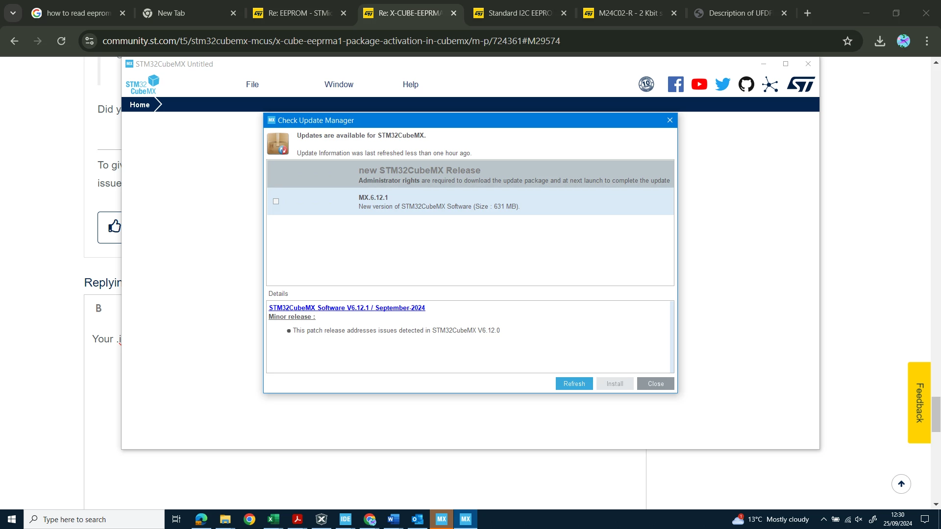

OK.
Could you please uninstall the old version (you didn't mention the version you have) and download/install the latest version: 6.12.1?

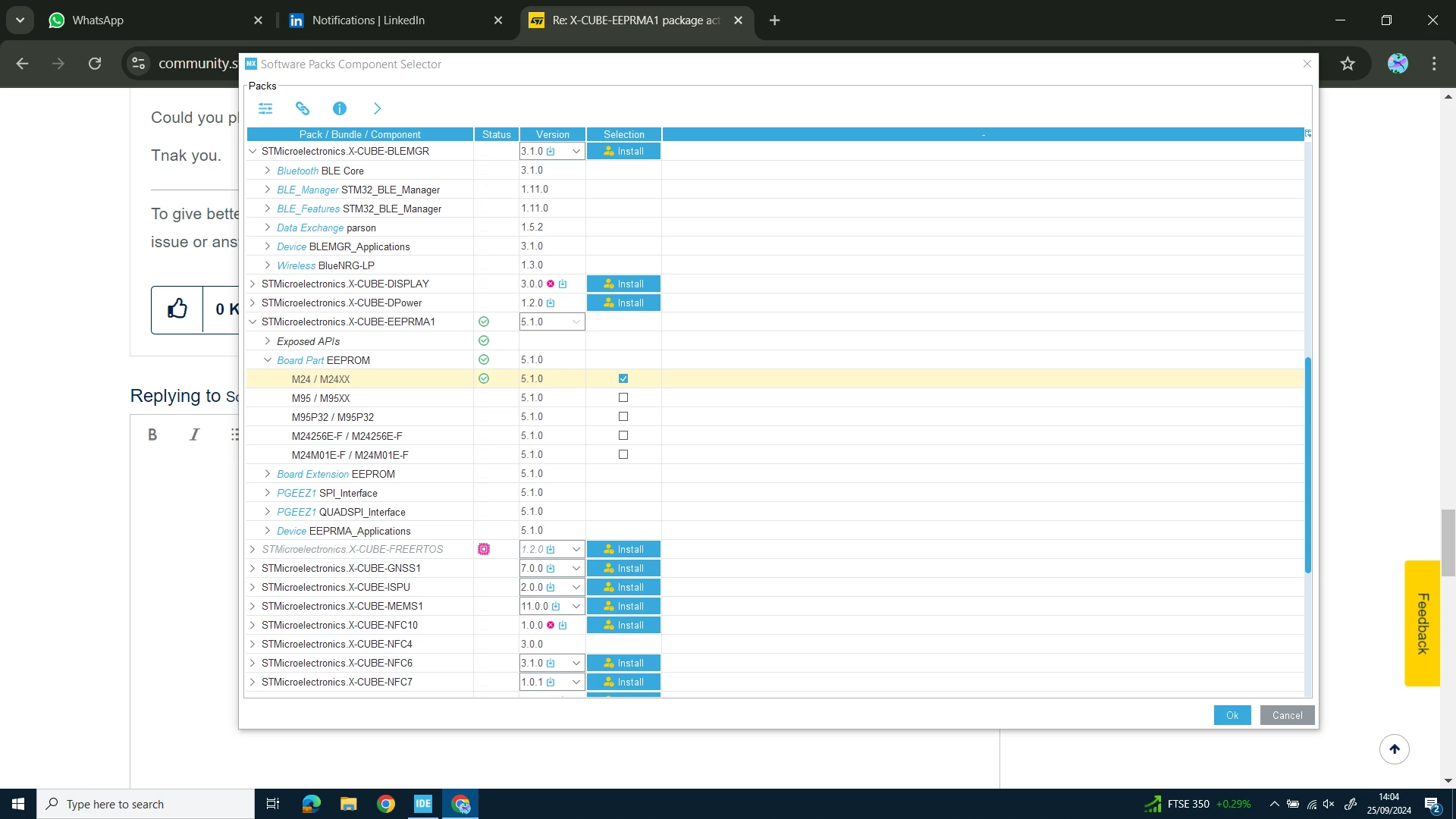

Hello @meena ,
You need to check one of the available drivers:
For example, for M24 / M24XX, check the box on the right and click OK.
In "Middleware and Software Packs" menu , click on X-Cube-EEPRMA1 and check the box "Board Part EEPROM"
After generating the code, M24XX driver is included in the project.
Attached an example of ioc file.
Hope it helps.

Hi Thanks  yes but for some reason I am not able to tick (enable )the driver  or install.May I know what is wrong
mƎALLEm
September 25, 2024
Sorry, I didn't understand. Did you try the ioc file I provided ?
I'm able to open the EEPROM driver
Which driver you are not able to open:

Your .ioc says 6.12version and Iam unable to migrate my cubemx version for updates

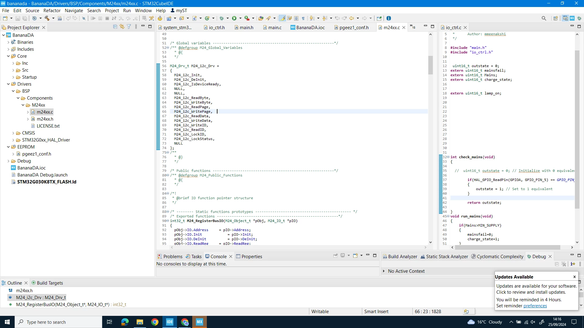

meenaAuthor
September 25, 2024
After cubenx update and a reboot I can able to do what I need. Verymuch thanks for you support
