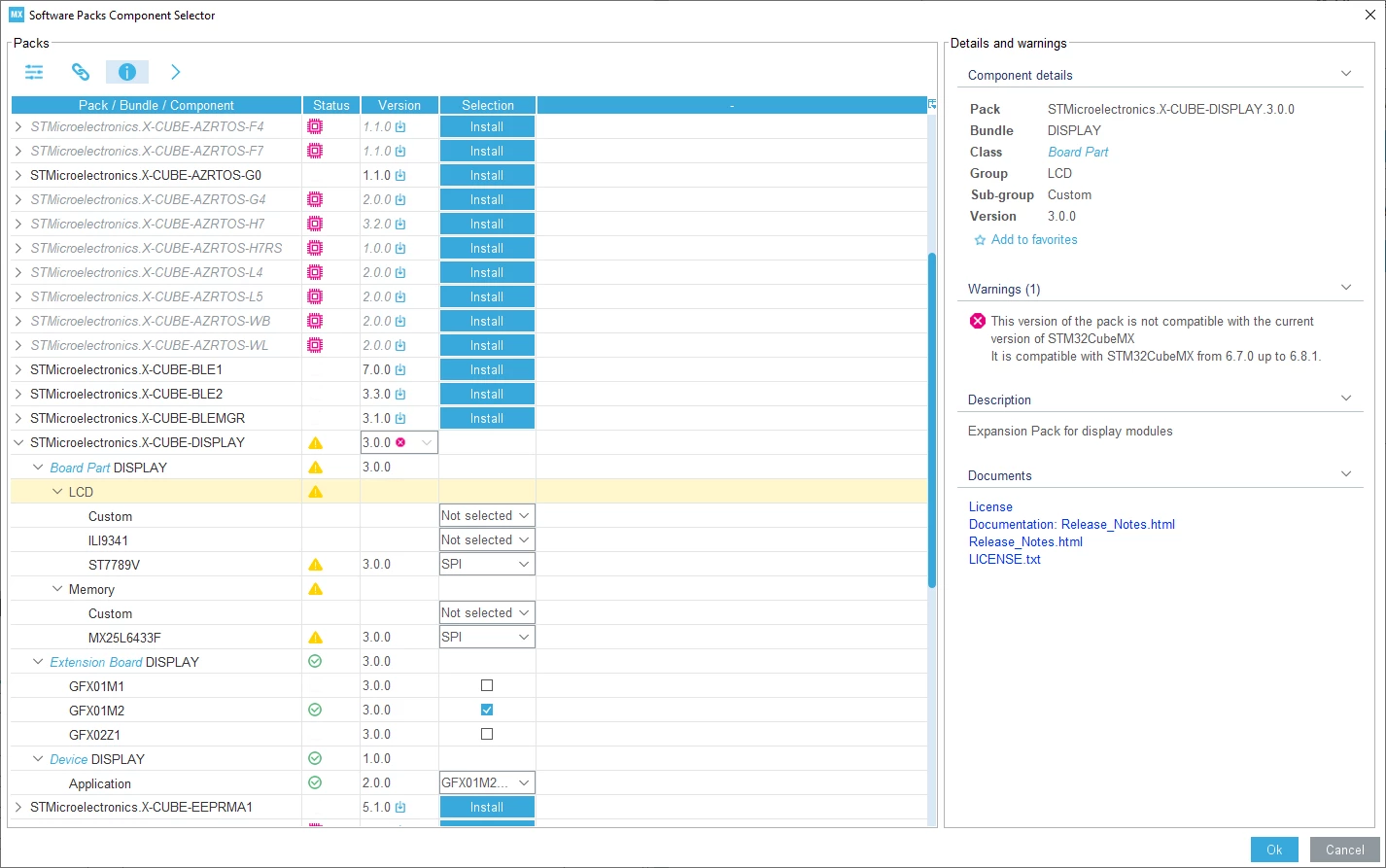

X-Cube-Display could not be configured to Board: NUCLEO-B071RB over STM32CubeMX

We loaded the latest STM32CubeMX: Version: 6.11.0
Configuring the Software-Packs will list the following Warning/Error: "
This version is not compatible with the current version of STM32CubeMX.
It is compatibel with STM32CubeMX from 6.7.0 up to 6.8.1   !!!
Is there a workaround?
Could the team for the expansion-boards fix the version update?

Hello @RWM_KHE_1 and welcome to the ST Community :smiling_face_with_smiling_eyes:.
If you want to use this package, You should use one of the mentionned version of CubeMX.
