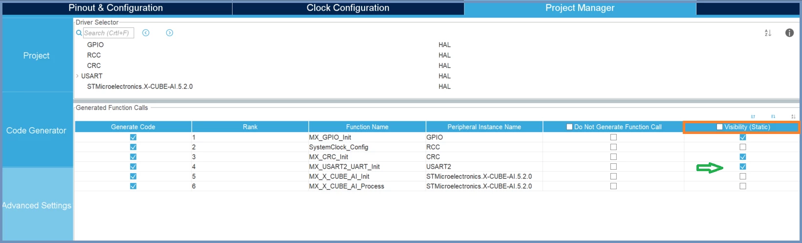

In fact, you can change the Functions Visibility directly through CubeMX and according to your need, you can find this option under Project Manager- Advanced Settings as mentioned in the image below:
Hope my answer helped you, when your question is answered please close this topic by choosing Select as Best, this will help other users find that answer faster.

Hi, thanks for your answer.
This is indeed the proper way to solve this problem.
However, in a previous version (it may have been STM32CubeIDE 1.2.0 and X-CUBE-AI 5.0.0, not sure), I did not encounter this problem to begin with. After creating a fresh project and adding the Validation template of X-CUBE-AI, the project could be built immediately without changing the MX_USART2_UART_Init() function visibility.
I think the visibility should be automatically changed when adding the Validation template of the X-CUBE-AI package.

Hi again @piernov​
Actually, when the function is generated as static, it will be initialized only in main.c, in case when it's generated as non-static, it will be defined also under main.h, so that the problem will not appear.
Could you please check with the latest CubeMX/IDE versions (6.2.0 and 1.6.0)?
