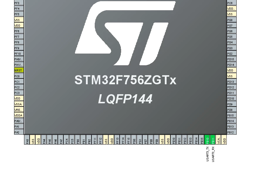

On my Nucleo-F756ZG, when I generate code for USART3 that's by default connected to ST-LINK , Cube sets pins for morpho connector (PB10 PB11) instead of alternate function (PD8 PD9). I also use Nucleo-L476RG and for this board, Cube set alternate funtion pin for Usart2 default connected to ST-LINK.

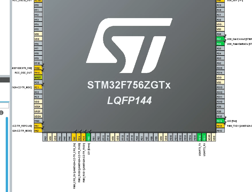

Hello @kamil Duljas​
First let me thank you for posting .
I checked with CubeMX 6.8.0 and this is what I got concerning USART3 pins on Nucleo-F756ZG
_legacyfs_online_stmicro_images_0693W00000bi1IHQAY.pngUSART3_TX-->PD8
USART3_RX-->PD9
Thx
Ghofrane

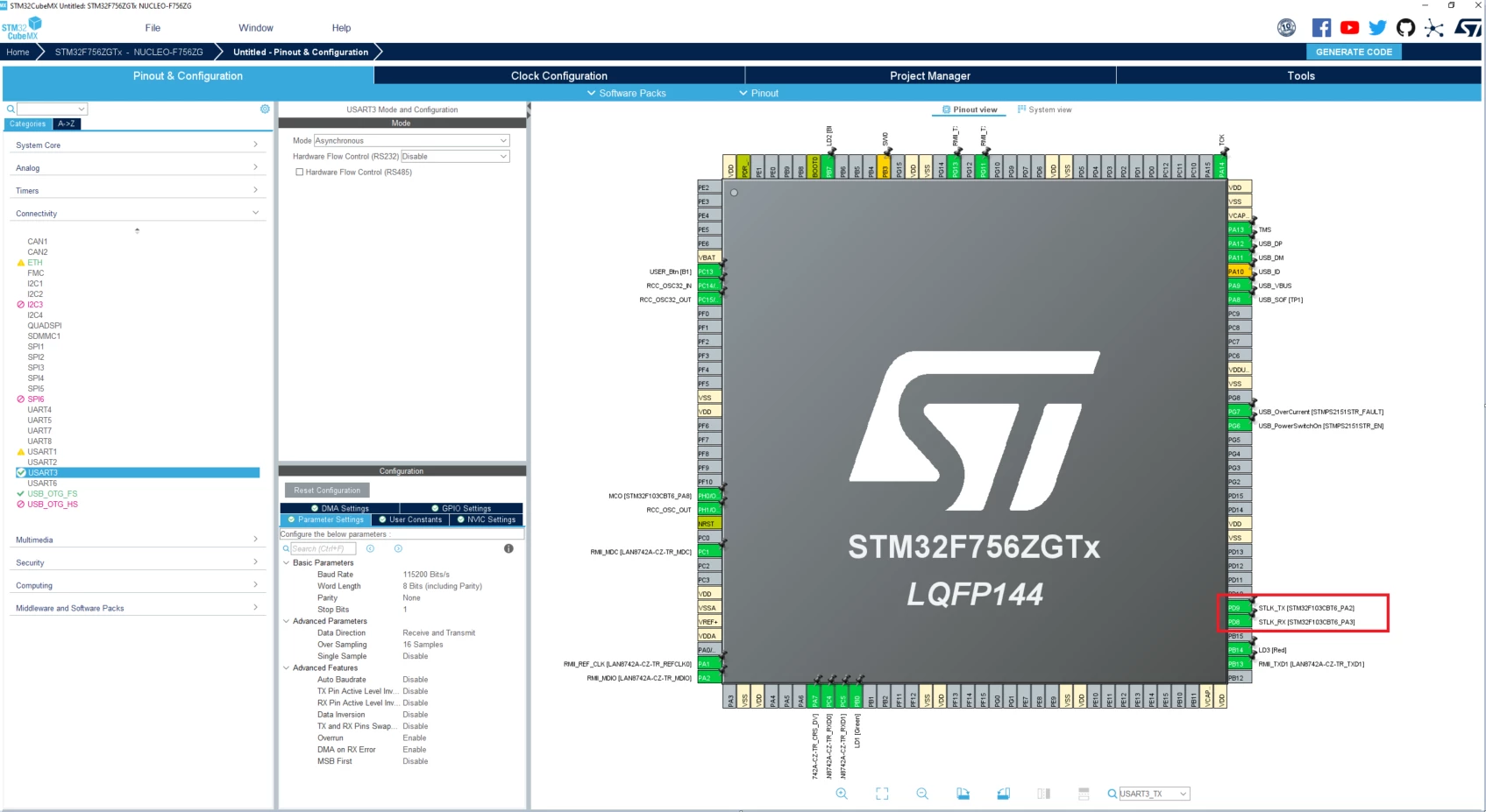

Senior III
April 13, 2023
Sorry, i forgot mention that i set it in STM32CubeIde:

Also in CubeMx, when you uncheck pd8 and pd9 pins and enable usart3 it set other pins

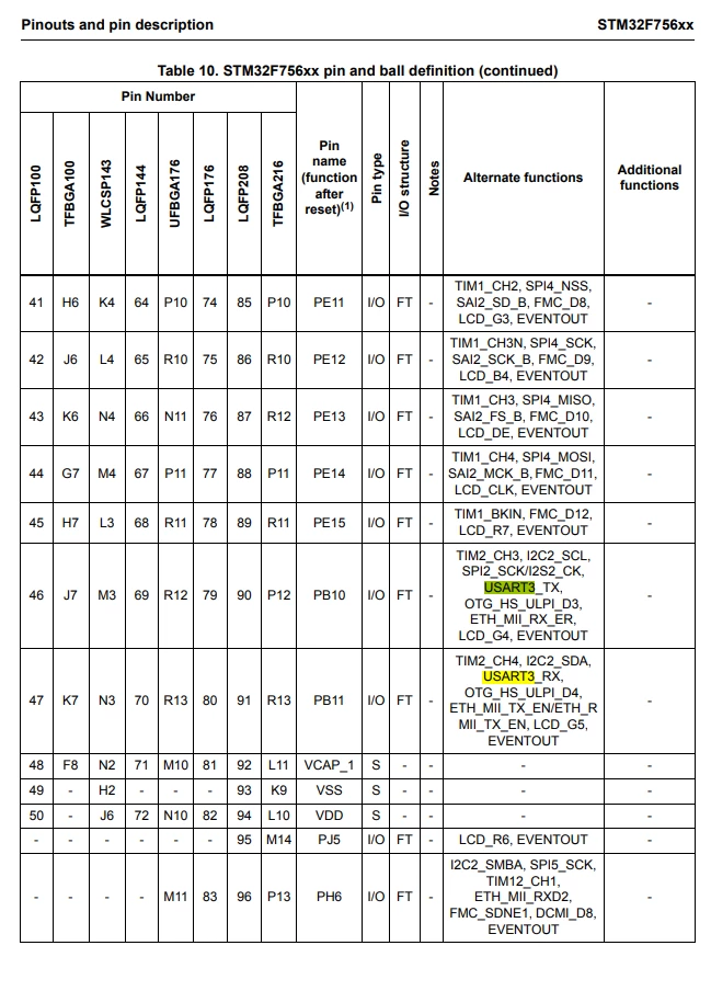

Hello again @kamil Duljas​
By checking the datasheet ,and based on Table 10. STM32F756xx pin and ball definition (continued)
_legacyfs_online_stmicro_images_0693W00000bi1NRQAY.pngUSART3_TX-->PB10
USART3_RX-->PB11

I know and it is ok. I didin't say that the pins is completely wrong. I notice that on Nucleo L476 after choose USART2 CubeMx is setting pins connected to st-link, but on F756ZG Not. The User must find alternate funtion for USART3 there are connected with ST-LINK. In my opinion it is not consist and sure it is not user friendly
