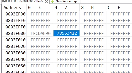

ajimathewAuthor
July 18, 2023
Thank you @KDJEM.1 .
I referred the above reference. It worked
But when I read the manual "rm0432" It is given that
The Flash memory programming sequence in standard mode is as follows:
1. Check that no Flash main memory operation is ongoing by checking the BSY bit in the
Flash status register (FLASH_SR).
2. Check and clear all error programming flags due to a previous programming. If not,
PGSERR is set.
3. Set the PG bit in the Flash control register (FLASH_CR).
4. Perform the data write operation at the desired memory address, inside main memory
block or OTP area. Only double word can be programmed.
– Write a first word in an address aligned with double word
– Write the second word
5. Wait until the BSY bit is cleared in the FLASH_SR register.
6. Check that EOP flag is set in the FLASH_SR register (meaning that the programming
operation has succeed), and clear it by software.
7. Clear the PG bit in the FLASH_SR register if there no more programming request
anymore.
My code is
uint64_t data=0x1234567890ABCDEF;
HAL_FLASH_Unlock();
HAL_FLASH_Program(FLASH_TYPEPROGRAM_DOUBLEWORD,0x0803F000,data);
HAL_FLASH_Lock();
 The data have been stored in the desired address. My doubt is, as per the manual I didn't set PG bit and check any status of the flash register but I got an output how?
