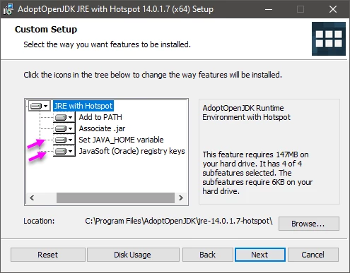

May 14, 2020
To easily fix this, install AdoptOpenJDK with the following settings:0693W000001cFYDQA2.png
shadab abedin
August 26, 2020
thanks @Community member​  lastly it work after installation of adoptOpenJDK.Thanks Alot
