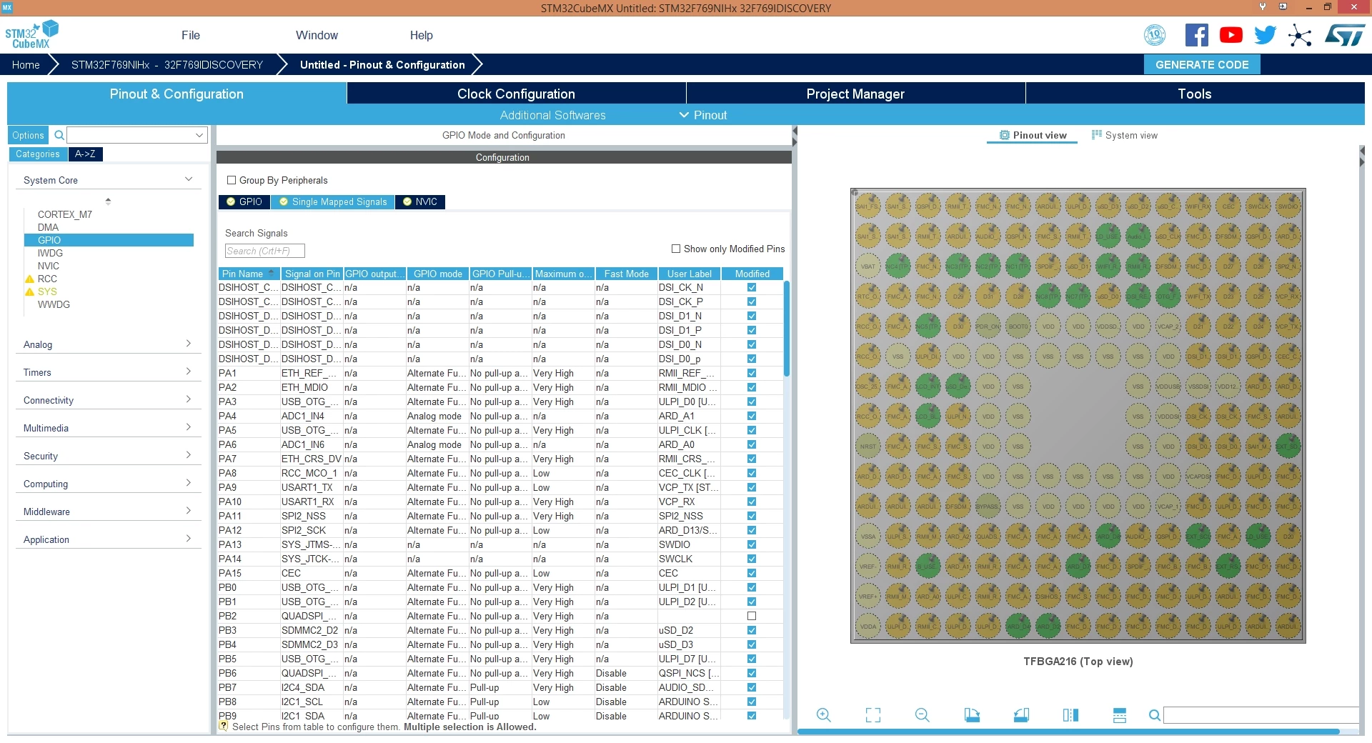

I'm using STM32CubeMX Version 5.1.0 and downloaded the Firmware Package STM32Cube FW_F7 V1.15.0, when requested by the CubeMX.
I was able to select the STMicroelectronics STM32F769I Discovery Board and use all the default names and configurations for the pins, generate the code and compile successfully a test application (with Keil compiler) (all in less than 10 minutes)
I'm not sure why you were not able to configure a test project previously, but I would suggest give it another try, because the tools do work.

I can see the value of these tools to people who already know everything about this chip and just want help organizing it. For a company that is already heavily invested in ST, I imagine CubeMX is quite handy. However, I am not in that group; I am building my company's first ARM product.
When I used the default configuration for my board, I noticed two things: first, over half the pins were yellow, which made me wildly uncomfortable (I do not ship products that compile with warnings), and second. the Graphics were disabled by default. And I couldn't figure out how to enable them. Since graphics were a critical part of my evaluation this was an immediate problem.

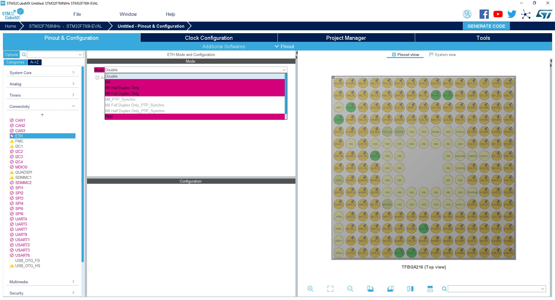

I too am evaluating the F7 (actually H7 but we can't get hold of an eval board) for an upcoming project. CubeMX sounded great on paper, but unfortunately it hasn't lived up to the marketing hype. My first demo project used ST's flagship evaluation board - STM32F769I. After loading the package into CubeMX and accepting the defaults I noticed nearly all the peripherals had conflicts. I set my self the task to get the Ethernet HAL enabled. Hours later I'm still no closer. I have disabled every peripheral on the board and yet it still complains about conflicts. Unless they are resolved, it doesn't allow you to link in the TCP/IP stack (LwIP) which is the whole point.

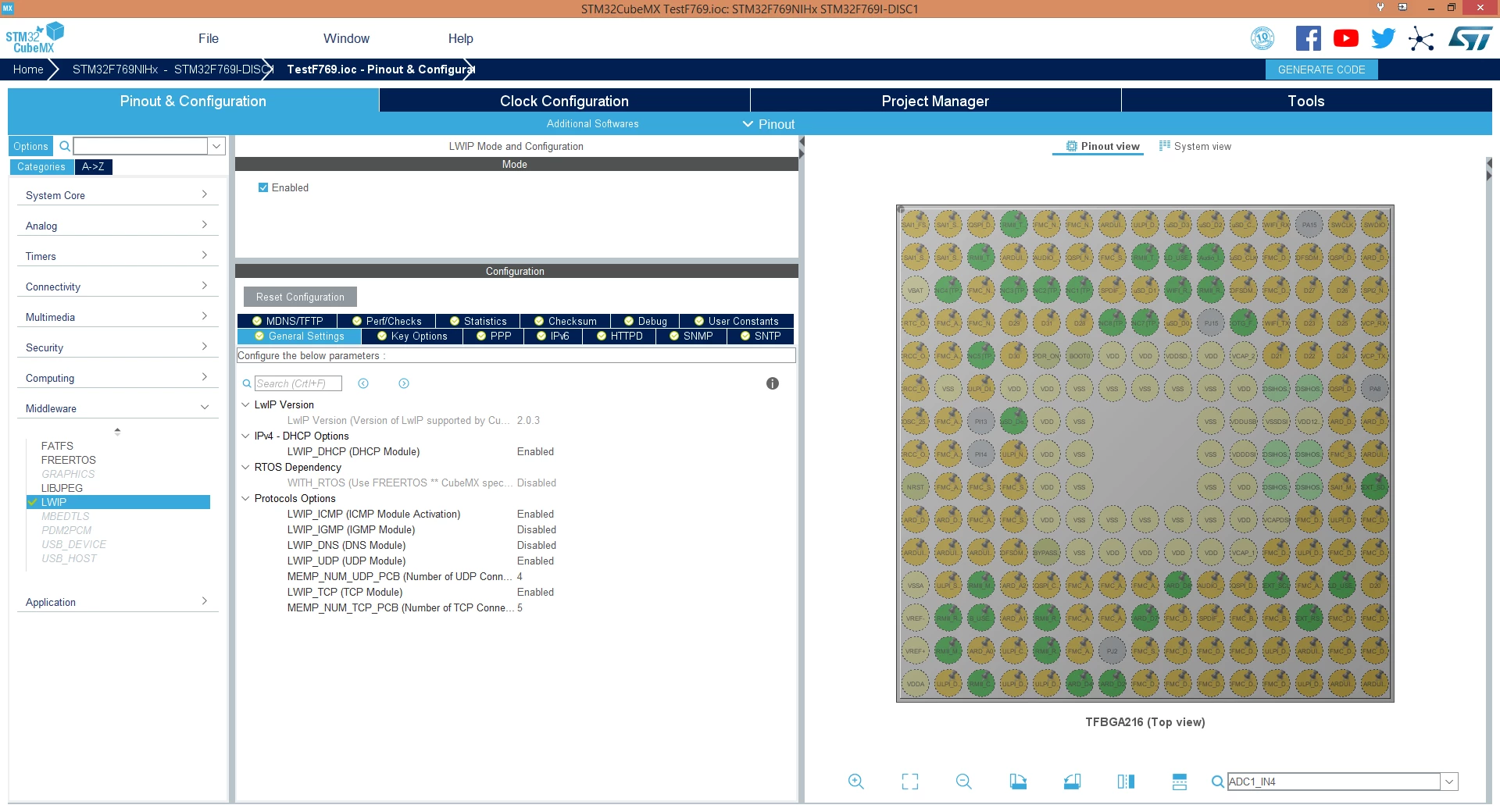

Alex R
Apr 22, 2019 2:42 PM UTC
Please try again with a new project, but do not choose the default values to initialized the peripherals.
See the attached picture below. It is possible to enable the LWIP Middleware without any conflict.
DOsbo
Apr 23, 2019 2:37 AM UTC
Hi Alex, thanks for your reply. I should have been more precise. I'm using the Evaluation Board STM32F769I-EVAL. I can see the discovery board does work like you said. However the STM32F769I-EVAL board starts out like this:
I think it has something to do with the FMC address/data lines taking up too many pins. I might have more luck if I start with just the micro (not board) and build the configuration up myself instead of taking things away from the board configuration.
