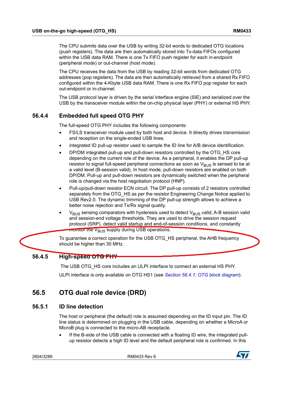

why USB is not recognized when I reduce the clock speed? and How to keep it working at low clock speeds
I am using STM32h743 , code is generated using STM32CubeMx.
I am using USB_OTG_FS in device only mode, with USB_DEVICE middleware configered as CDC class .
Here's my clock configuration
I could reduce the clock from 480MHz to 120 MHz by changing RCC_OscInitStruct.PLL.PLLP from 2 to 8 .
But when I try to change clock to 96MHz or 80 MHz by changig RCC_OscInitStruct.PLL.PLLP to 10 or 12, the USB is not recognized by windows!!!
I am using windows 10 .
How to overcome this problem?

OK so try with decreasing the clock change the AHB prescaler so that AHB frequency stays at or above 60MHz.
Did that change anything?

When I change RCC_OscInitStruct.PLL.PLLP fro 2 to 8 the AHB Clock is reduced from 240MHz to 60MHz,
when I set RCC_OscInitStruct.PLL.PLLP to 10 the AHB clock is 48MHz
when I set RCC_OscInitStruct.PLL.PLLP to 12 the AHB clock is 40MHz
So the AHB Freuquanc is still greater than 30MHz
HAlzo
HAlzoAuthor
May 14, 2020 9:35 AM UTC
0693W000001cFUuQAM.pngyes, it's working
reducing main CPU clock while keeping AHB clock high solves the problem

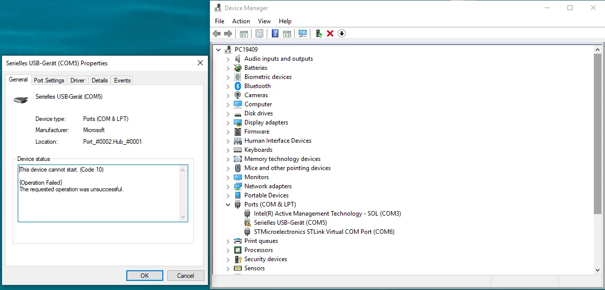

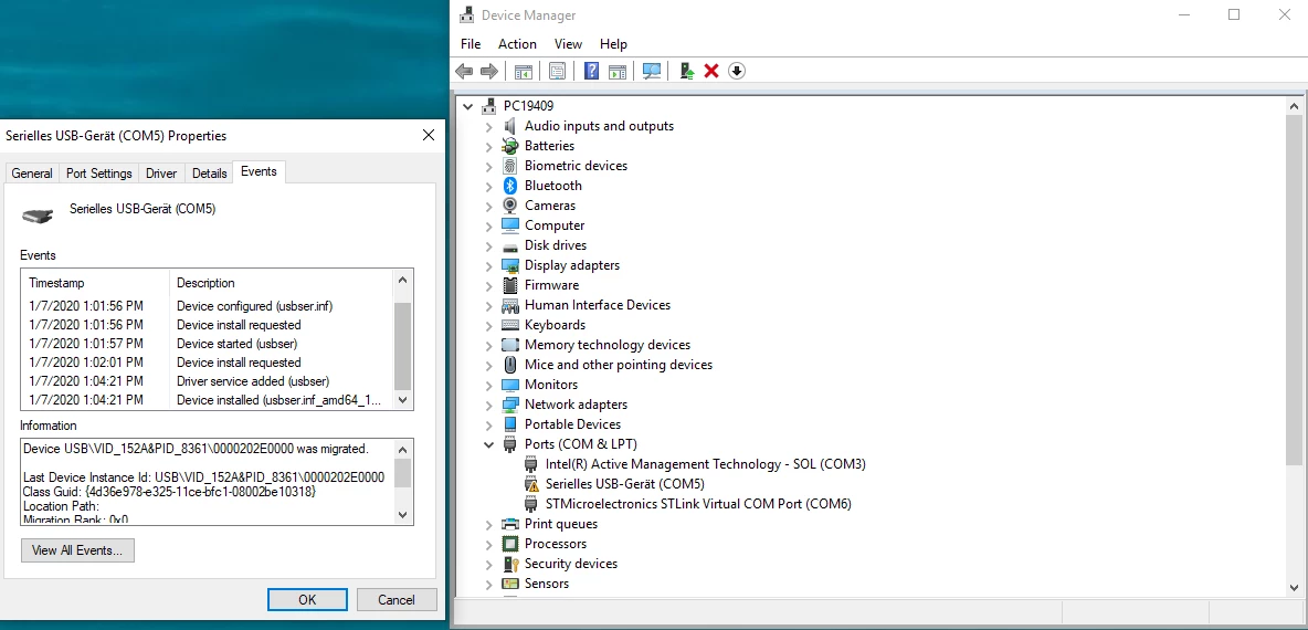

Sometimes the USB device is mapped to different VCOMPort even that I am using the same serial number string descriptor
and sometimes The device is not recognized by Windows as shown in the attached pics0693W000001cIISQA2.png0693W000001cIINQA2.png
waclawek.jan
May 14, 2020 8:11 PM UTC
Sorry, I don't have a magical answer to all the bugs which come with Cube, or may be introduced by yourself, or Windows, or the used hardware...
