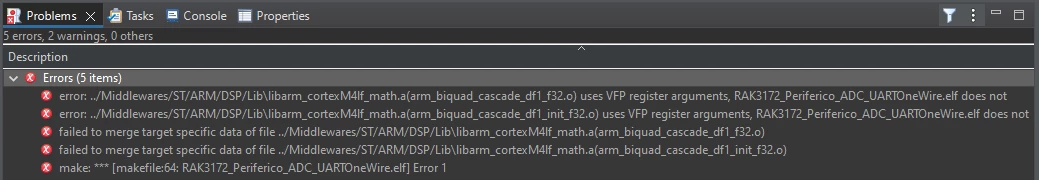

I'm trying to use the DSP Library on the STM32WLE5CCU6 and some error messages appear on STM32CubeIDE. I have the same code tested and running on STM32F103C8T6 and STM32F407VET6 without any problem.
STM32CubeIDE Version: 1.14.0 Build: 19471_20231121_1200 (UTC)
STM32CubeMX Version 6.10.0
STM32CubeWL Firmware Package v1.3.0 / 09-November-2022
STMicroelectronics.X-CUBE-ALGOBUILD DSP Library Library 1.3.0
I'm seriously thinking about switching to using any other STM32 with an external SX1262 chip via SPI interface than the STM32WL with its related libraries. The LoRa middleware is impossible to work with, I am forced to provide an UART interface  (Why not use SWV / ITM interface ?) and the ADC , I cannot disable it.

I suggest you follow the same steps on the FAQ recommended by my colleague @Amel NASRI  but on the step:
* From Project menu or File menu, go to Properties > C/C++ Build > Settings > Tool Settings > MCU CGC Linker > Libraries > Libraries (-l) > Add insert the following library: "arm_cortexM4l_math" and not the "arm_cortexM4lf_math".
Best Regards.

This looks to be a disparity between the build settings for the RAK3172 project, and the library.
ie FPU enabled and the appropriate softfp / hardfp option for the ABI, likely buried in the meta-data or target settings

> Will I not be able to use the DSP CMSIS
From error shown -> you mix a lib that is using hardware FPU with other, using that uses only software float lib.
This wont work (I know....guess why ?) , according to the basic project you have to set your cpu compiler options (hard, soft, mix) and if choose some cmsis DSP lib, you have to take one for this setting.
