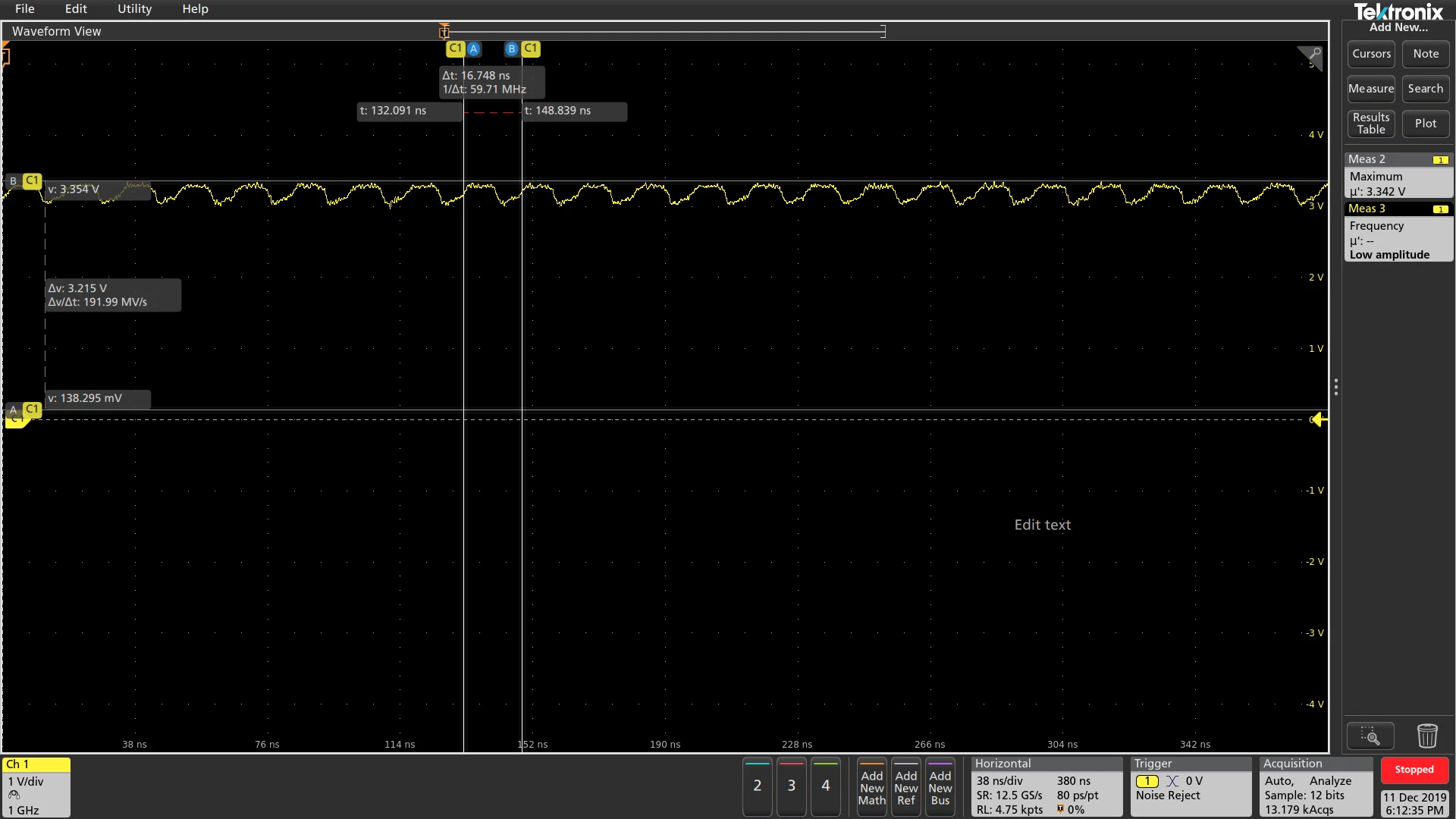

Likely not starting due to characteristics of circuit as built. Check or change loading capacitors.
Route LSE clock to PA8 MCO so you can scope signal without altering loading with scope probe.​

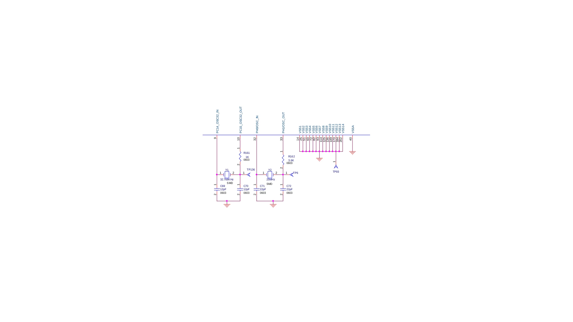

we measured the LSE clock in PA8 port using MCO1. We did not get the expected clock .
Attached the waveform we got.
We have calculated and used load capacitors as per STM32 crystal guidelines. We assumed stray capacitance to be 0.5.
Attached the crystal circuit.
