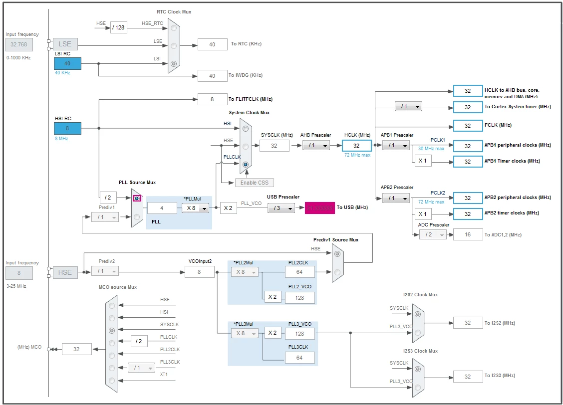

Why stm32f105 clock configuration disable HSE configuration ?
I tried install different Cube version ,include latest version on 2 windows computers . both them are disabled HSE configuation in clock configuation dialog.
Since HSE disabled and USB clock also inavliable.
Who can tell me why and how solve this issue. ( Manually coding please skip, I mean this tool, STMicoelectronics launched tool)
TDKBest answer
Sep 22, 2020 1:08 AM UTC
HSE must be enabled in the System Core -> RCC peripheral before it's available on the clock configuration screen.
