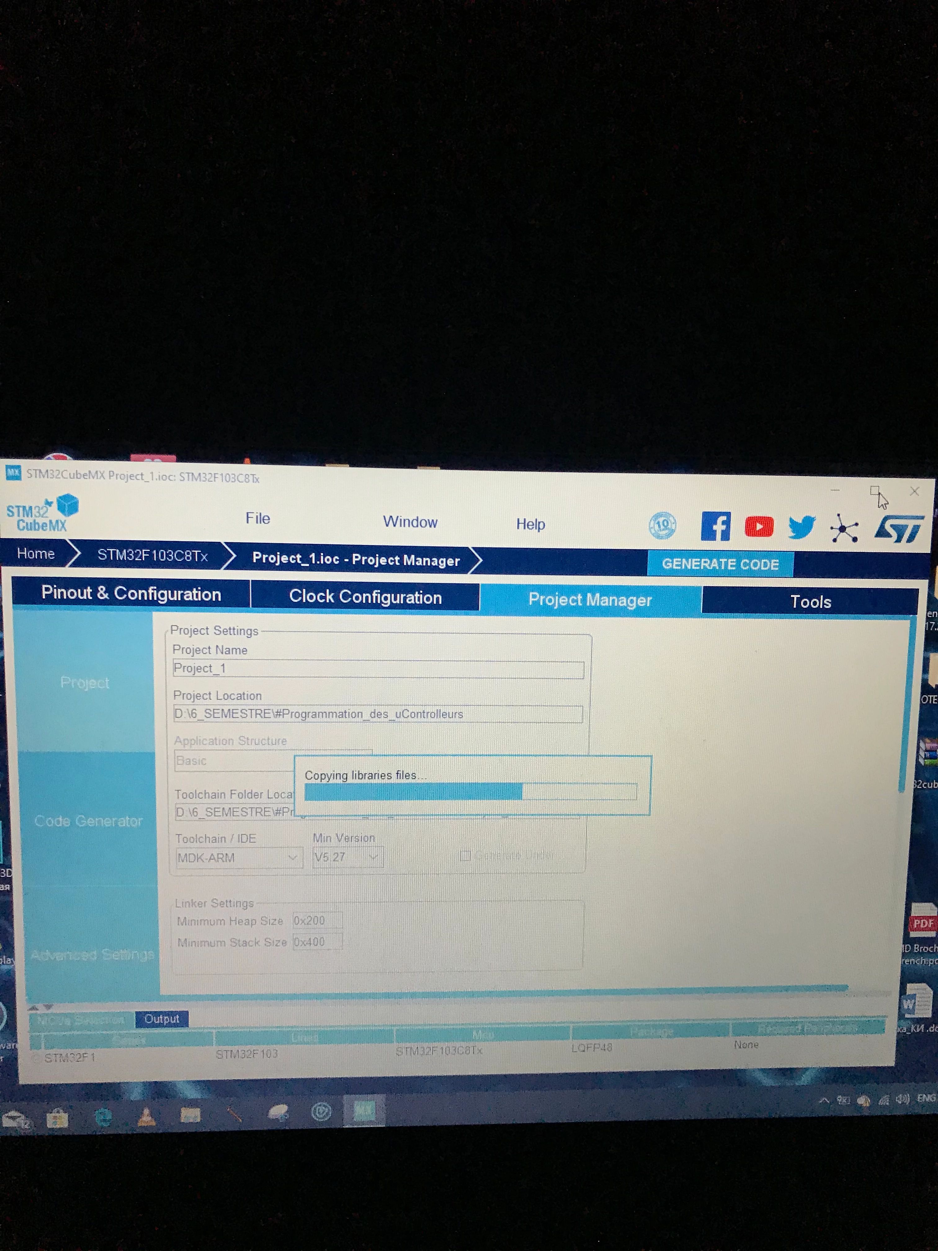

Why STM32CubeMX istucking while copying files for code generation ?
Hi, I can't fix why cubemx is stucking while copying files for code generation. I'm using Win 10 (64bit) and Java_Runtime_Environment_(64bit)_v8_Update_45. Can someone please help understand how to fix it ?

Imen DAHMEN, hello,
thank you very much for your help. I have already been able to solve the problem. I had a specific character « # » in the path of my project folder.

Mar 24, 2020 8:10 AM UTC
Which STM32CubeMx version are you using ? If possible provide your ioc file for check, this will help our CubeMx team to answer you.

Mar 24, 2020 8:38 AM UTC
Hello @Imen DAHMEN​ , i'm using STM32CubeMX 5.6.0 (the last version on the site). Trying to generate code for stm32cube_fw_f1_v180 package.
Please check the attached ioc file
Mar 31, 2020 4:47 PM UTC
Hello @CChuk.1​ ,
I tested your attached ioc file using STM32CubeMX v5.6.0 and STM32CubeF1 V1.8.0 in Win10 and I generated successfully the project.
Try again, otherwhise uninstall STM32CubeMx, then reinstall it.

Apr 3, 2020 9:36 AM UTC
Imen DAHMEN, hello,
