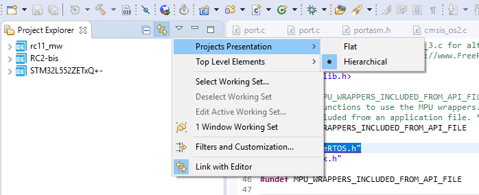

​Hi @MShak​
Try to check if Project Presentation is checked as Hierarchical.
Regards,
Nesrine

I tried to keep STM32CubeIDE open while generating code from STM32CubeMX, but that didn't help. I also tried to change Application Structure in STM32CubeMX Project Manager from Basic to Advanced, and to change Projects Presentation in STM32CubeIDE from Flat to Hierarchical, but that also didn't work. Whatever I do, I never get .project and .cproject files, and I always get the same message as @MShak​ :

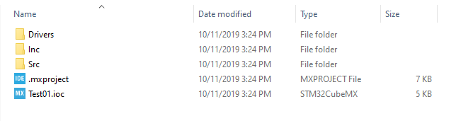

Yes, it obviously works on your system, but this is what standalone STM32CubeMX generates for me:
I am using standalone STM32CubeMX v5.3.0, which version do you use?
Below is the procedure that I am doing on my computer. I tried to use the simplest possible configuration just to make it easy to reproduce
  1. Access to Board Selector: NUCLEO-F303K8
  2. Initialize all peripherals with their default Mode?: Yes
  3. Project Manager:
    1. Project Name: Test01
    2. Project Location: C:\STM32Test
    3. Toolchain / IDE: STM32CubeIDE
    4. MCU Reference: STM32F303K8Tx
    5. Firmware Package Name and Version: STM32Cube FW_F3 V1.10.0
  4. Generate Code
I performed this same procedure with three different boards, and I never got project files (.project and .cproject) generated
  1. NUCLEO-F303K8
  2. NUCLEO-F303RE
  3. STM32072B-EVAL
I also tried to go through Access to MCU selector, to select STM32F103C8, select STM32CubeIDE in Project Manger and to click Generate Code, but the result was the same, no project files.
Can you please try to reproduce this same sequence on your system?
Do you have any advice for me, am I doing something wrong?
Thanks in advance!
-Marko

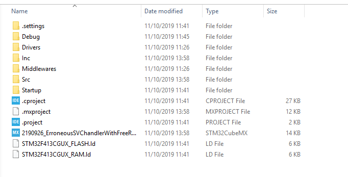

I was having this same problem, generating code from the Motor Control Workbench for the STM32CubeIDE. I read in the SDK User Manual (UM2392), page 4, "Note: STM32CubeMX must be run at least once before the MC SDK can be installed". So I uninstalled MX, IDE, Workbench and then re-installed the MX and IDE; ran MX once before re-installing the Workbench. Now when I generate code for the STM32CubeIDE, I get the appropriate project files created, (.cproject, .project, .mxproject), and the project imports into STM32CubeIDE (Eclipse).

Hello @DMatt.2​ ,
Thanks for sharing your solution. ST just released STM32CubeMX v5.4 and it looks like they have fixed the problem.
With new CubeMX, I was able to create a proper STM32CubeIDE project that containes both .project and .cproject files.
-Marko
