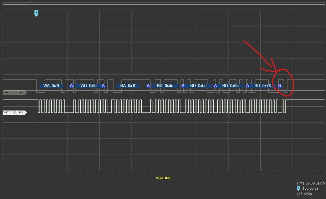

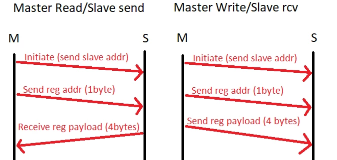

I am trying to write an STM32 as an I2C slave:
0693W00000UobFhQAJ.pngI wrote a code for it but when I run it, however, I get some weird stuff

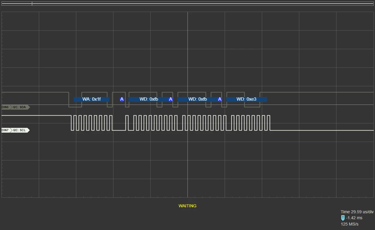

Here is the response when the master requests a buffer: You can see the NACK at the end right after the slave finishes sending the last byte
0693W00000UobFmQAJ.pngfor a master Write/Slave RCV operation: it goes wrong after writing the 2nd byte of the buffer. Why Am I having this? I'd scratched my head for months on this at this point
Here is the I2C code section of the STM32 slave:

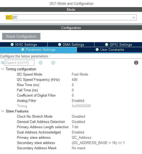

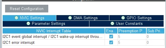

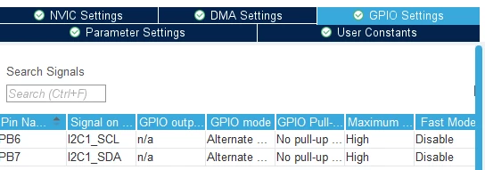

And here is cubeMX config for the I2C slave
0693W00000UobGBQAZ.png0693W00000UobGLQAZ.png0693W00000UobGQQAZ.pngAppreciate any insight you guys could have. Thank you!
