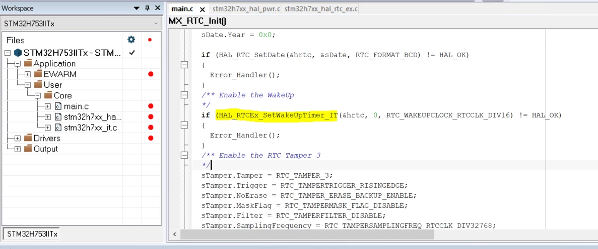

I want to enable RTC WKUP interrupt, so that I can use it later to wake the device up from sleep modes.
Nevertheless, CubeMX will also add HAL_RTCEx_SetWakeUpTimer_IT in init. I don't want to launch the timer in init! I only want to set it up for later use (setup interrupt handlers, NVIC enable).
  1. Is this call 100% necessary? Why CubeMX generates it in init?
  2. What does it mean if WakeUpCounter parameter to this call is 0?

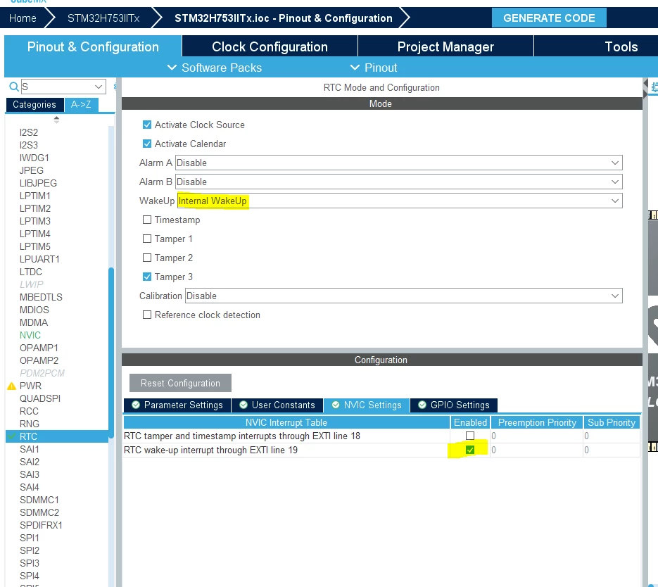

Yes STM32CubeMX calls this function when we activate the WakeUp, then go to the NVIC Settings table and Enable the RTC wake-up interrupt Through EXTI line 19.
0693W000005ARhCQAW.pngWhen we generate code: we get this function

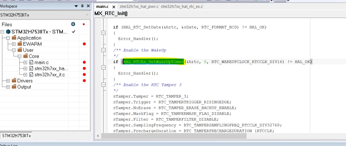

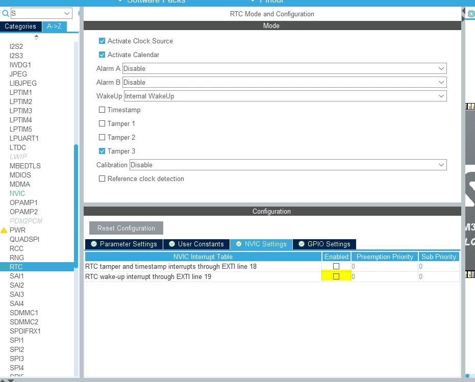

0693W000005ARi0QAG.pngWhen we uncheck the RTC wake-up interrupt Through EXTI line 19
0693W000005ARj8QAG.pngThen we go to the generated code: we get this function HAL_RTCEx_SetWakeUpTimer

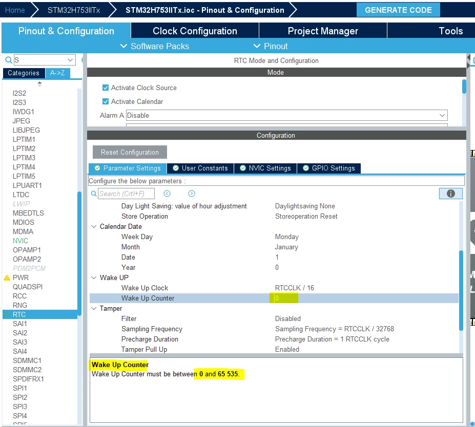

0693W000005ARkfQAG.png> What does it mean if WakeUpCounter parameter to this call is 0?
0 is the default value, you can change it :
0693W000005ARlsQAG.pngBest regards,
