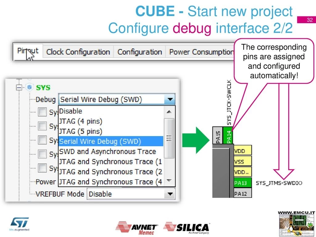

On other screenshots on the internet I see those options:

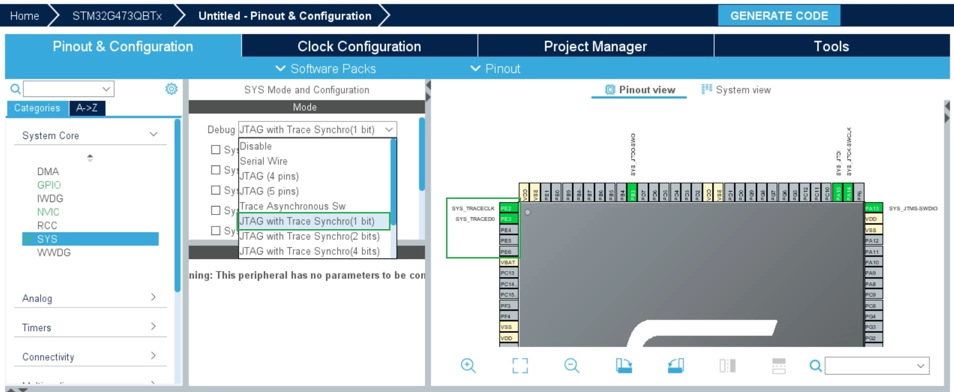

Selecting JTAG and Synchronous Trace (1 bit) for example will automatically activate PE2 and PE3 (TRACECK, TRACED0):

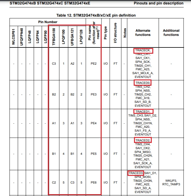

If you go back the STM32G474 Data Sheet, the TRACECK, TRACED0,TRACED1, TRACED2 and TRACED3 alternate functions could be only assigned to respectively PE2, PE3, PE4, PE5, PE6 and could not be remapped to any other pins :
