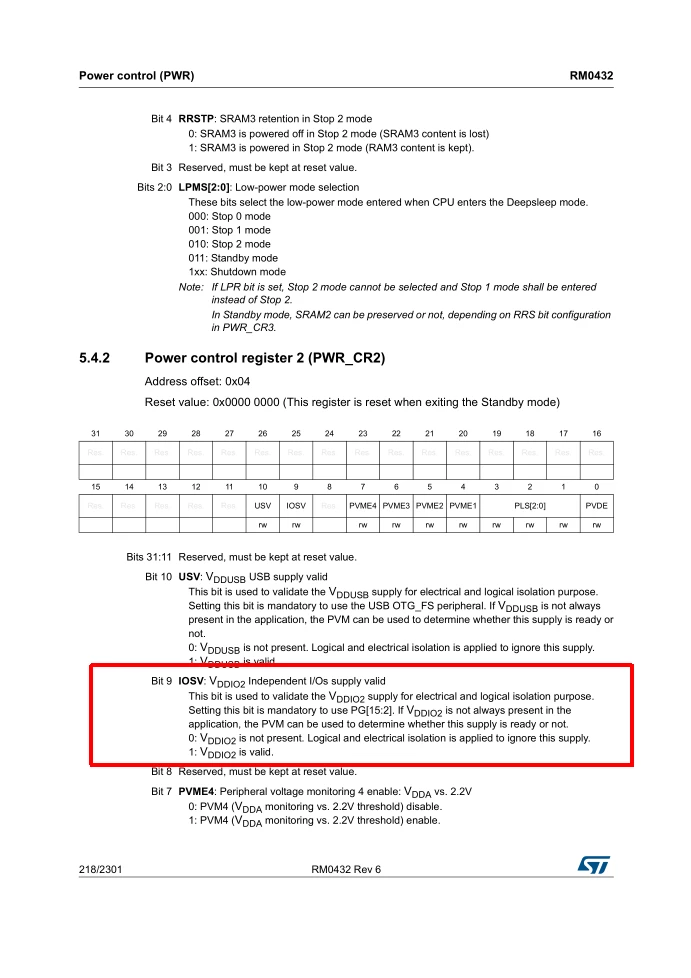

waclawek.jan
May 11, 2023 11:23 AM UTC
VDDIO2 pin is connected?
Is PWR_CR2.IOSV bit set?

Tesla DeLorean
Guru
May 12, 2023 9:26 AM UTC
To use GPIOG bank pins there must be a VDDIO2 supply and you must explicitly enable it in your code somewhere. ​
XIAOHE
XIAOHEAuthor
May 12, 2023 10:23 AM UTC
@Community member​ So how do I do it?
Tesla DeLorean
Guru
May 12, 2023 10:56 AM UTC
  /* VddIO2 must be enabled to access GPIO port G[2:15] */
  __HAL_RCC_PWR_CLK_ENABLE();
  HAL_PWREx_EnableVddIO2();
  __HAL_RCC_GPIOG_CLK_ENABLE();
Where you initialize the pins, or in SystemClock_Config()
waclawek.jan
May 12, 2023 10:39 AM UTC
PWR->CR2 |= PWR_CR2_IOSV;
Or, as an experiment, look at the PWR_CR2 register in the debugger and click there to set the IOSV bit.

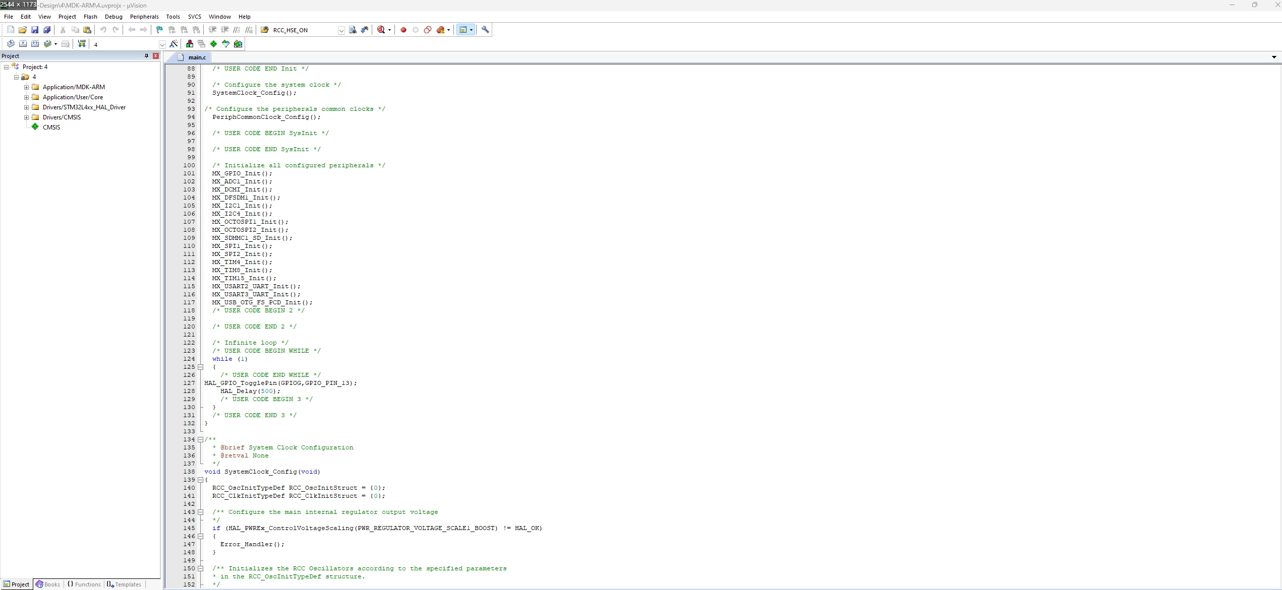

XIAOHE
XIAOHEAuthor
May 13, 2023 7:41 PM UTC

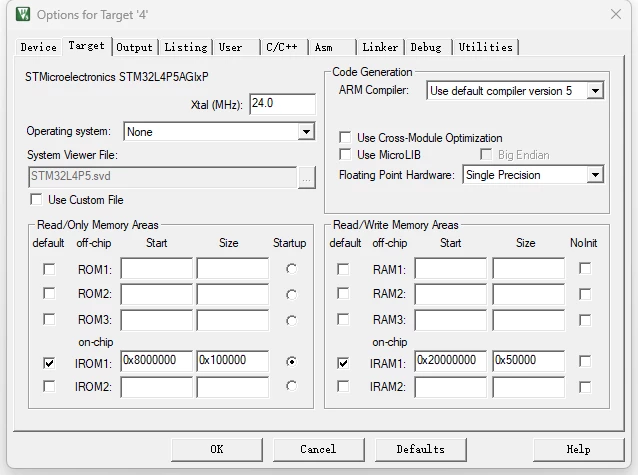

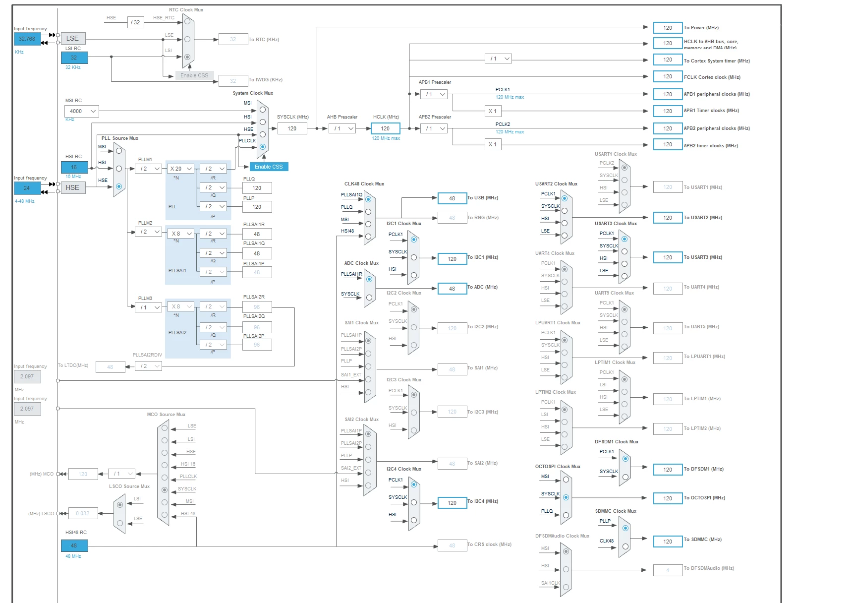

@Community member​ This is really bad, especially for a newbie like me. I've read a lot of manuals and know that iOSV is to be set to 1, but I can't make changes to the code. For other development boards, I just need to open the external crystal on the CUBEMX, configure its frequency in the clock tree, set the lamp level low, and finally import it into Keil to run. But not for STM32L4P5G-DK.Please help me. I want to know if there is something wrong with the initialization configuration in CUBEMX or if I have to add to make changes after the initialization
AScha.3
May 14, 2023 7:01 AM UTC
on STM32L4P5G-DK is no 24M crystal , clock is 8M from onboard stlinkV3 :
_legacyfs_online_stmicro_images_0693W00000bk1IQQAY.pngso set "bypass" clock and 8 MHz . then try ...
