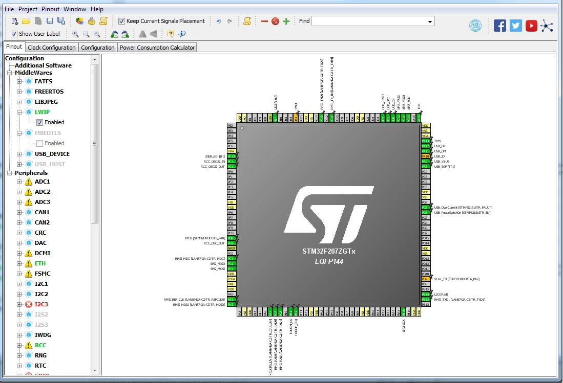

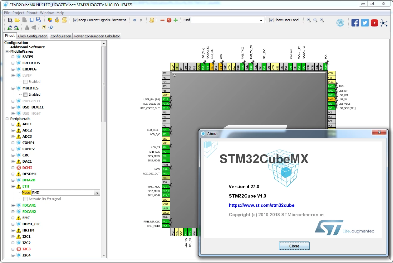

Hi.
 Why the option for LWIP is disabled on, STM32CubeMx v4.27, for the STM32H743?
 And, when using the STM32F207, the option MBEDTLS turn disabled when LWIP is selected and vice-versa? Can't both be used simultaneously?
Thanks in advance.

Hello @Amilton Rog�rio da Silva​ ,
To active LWIP, you should configure the ETH IP and enable FREERTOS with MBEDTLS.
Also, for STM32H7 CORTEX_M7 CPU DCache parameter must be enabled.
This warning is mentioned in STM32CubeMx, when you put the cursor in LWIP Pinout.
Kind Regards,
Imen
