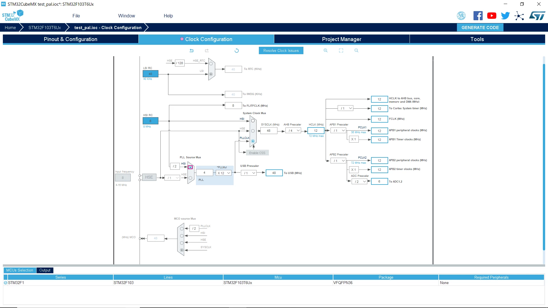

Why is my clock configuration NG on STM32CubeMX?
Hi, everyone
I am using the STM32CubeMX for the first time.​
I have a problem with clock configuration on it.
But I do not know why the problem is occurring.
I need help.

Hi @TFuji.4​
Try to click on Resolve clock issues. If it does not work, could you please send me your .ioc file to check the problem?

Hi Nesrine-san,
Thank you for your reply.
I tried a suggestion from you.
I tried clicking on Resolve clock issues.
​Next I clicked on Generate code and the following message was displayed.
I think the problem is not solved.
Please find the attached ".ico" file.

Hi @TFuji.4​
You must enable the RCC to solve this clock problem.

Hi, Nesrine-san
Thank you for your response.
I tried the suggestion from you, and the problem was solved.
