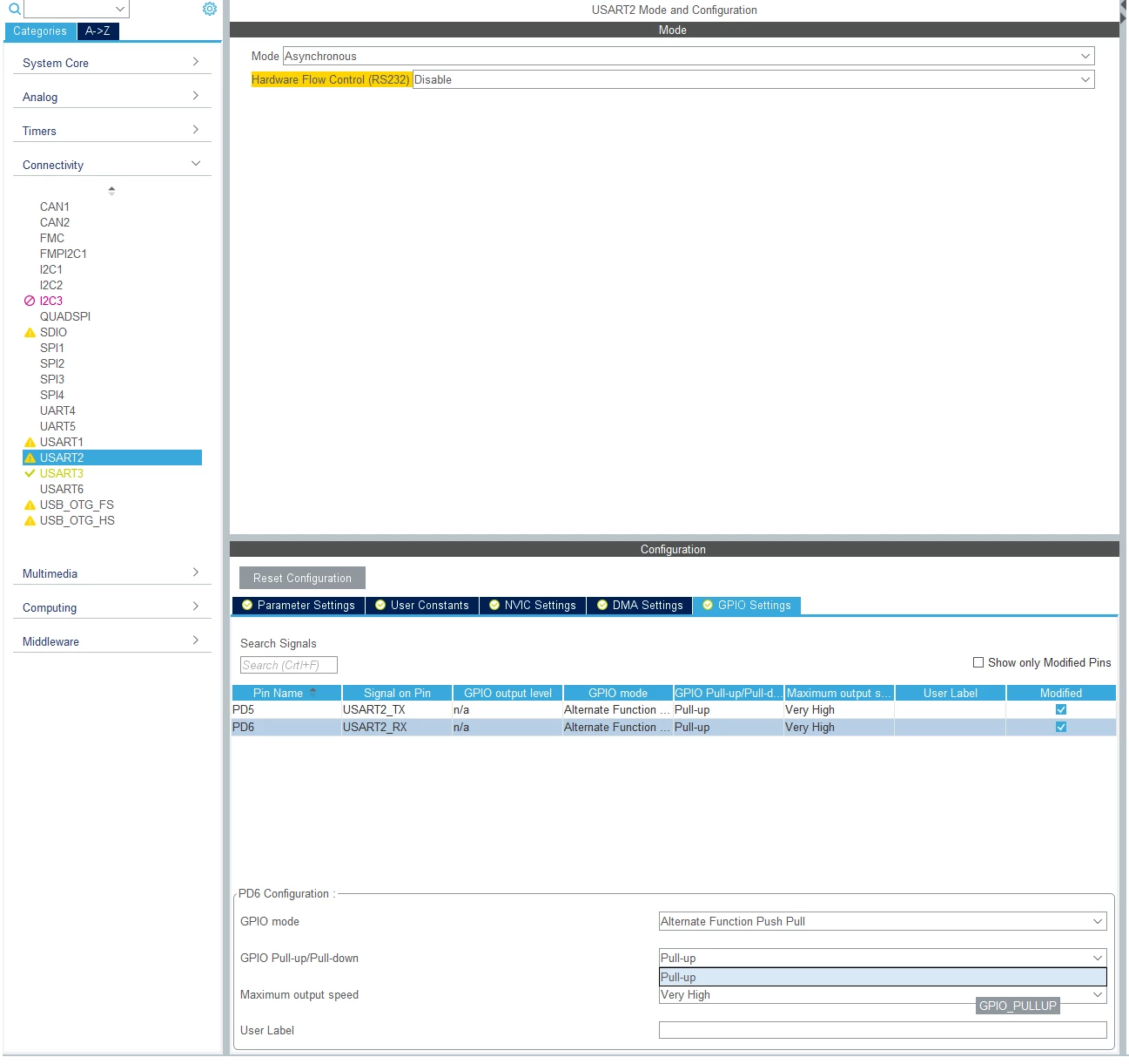

Hello everyone,
I have a system with two STM32F446 which are connected over the USART2 interface to be able to communicate with each other. One of the STM32F446 is powered with 3V3 and the other one with 3V.
I used CubeMX (version 5.3.0) to configure the USART mode as asynchronous. The GPIO's I would like to configure as alternate function push pull without any pull-up because of the different power levels. But in CubeMX I have to select a pull-up. Why I have to do this? How can I configure an asynchronus UART without pull-up on Tx line in CubeMX?

Because that's the status quo and monkeys writing code are not bothered with thinking!
Pull-up on Tx line really is useless and unnecessarily eats energy on transmit, but not enabling it will not change voltage levels with push-pull. To bring voltage levels to 3,0V, possibly for Your specific use You can try open-drain on 3,3V Tx and pull-up on 3,0V Rx, plus also turn off pull-up on 3,3V Rx. But then You must be sure that such a configuration is OK for specific line speed, length, environment noise and other physical factors.
P.S. Your screenshot shows Rx line, for which it is OK.

Okay that is the answer I was looking for=) I thought there might be a reason why pull-up in CubeMX can't be disabled.
My configuration now is push-pull on both Tx lines and disabled pull-up on both sides for Tx and Rx. My scope shows me that the signals are looking quite okay.

It may be related to https://community.st.com/s/question/0D50X0000BHyNbfSQF/what-state-are-gpios-in-if-they-are-set-to-alternative-function-but-the-controlling-peripheral-is-disabled - if the UART is disabled, the Tx pin's output enable may go inactive and the pin then may float to zero, possibly confusing the party on the other end of the wire.
It's not nice CubeMX does not allow to choose (with some sane defaults, and of course accompanied by extensive documentation and explanation ;) ) but that's your well-deserved punishment for using a clicky tool instead of proper programming.

Though on Rx sides pull-ups greatly lower an input impedance and therefore greatly improve robustness against EMI. If connection is wired, I would leave those on. =)
