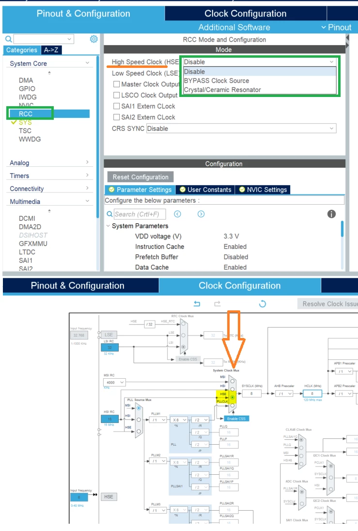

Why I could not configure HSE by Clock Configuration of CubeMX 5.3.0?
CubeMX ver. 5.3.0. I tried different microcontrollers.

​Hello @VKole​ ,
First you need to enable RCC in HSE mode then you can use it under Clock config.
Best regeards,
Khouloud.
