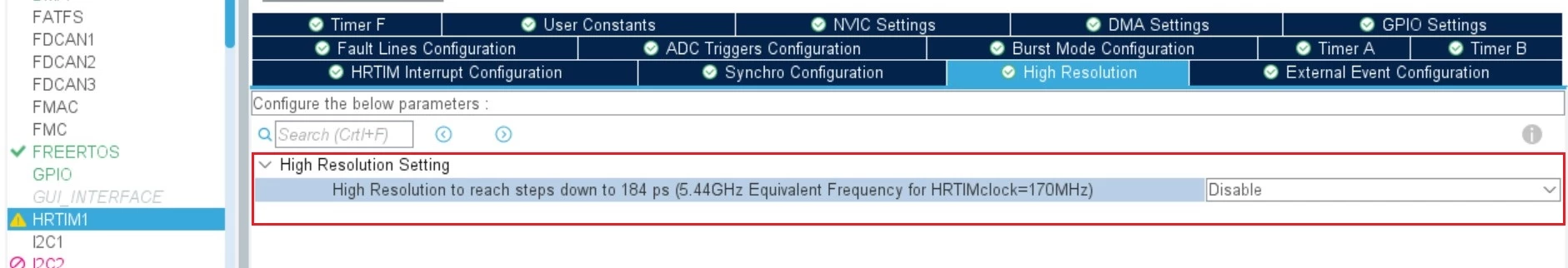

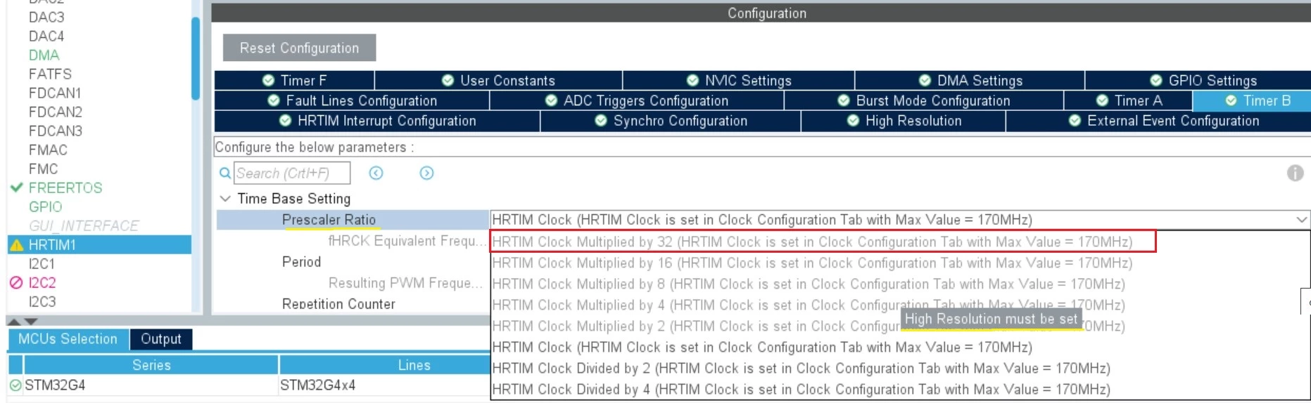

If I well understand your problem, and backing to your attached .ioc file, you're not able to select HRTIM Clock Multiplied by 32 prescaler ratio through CubeMX:
0693W000007D2VBQA0.jpgAs indicated by the displayed contextual help message when hovering the mouse over HRTIM Clock Multiplied by 32 prescaler ratio, the High Resolution should be enabled

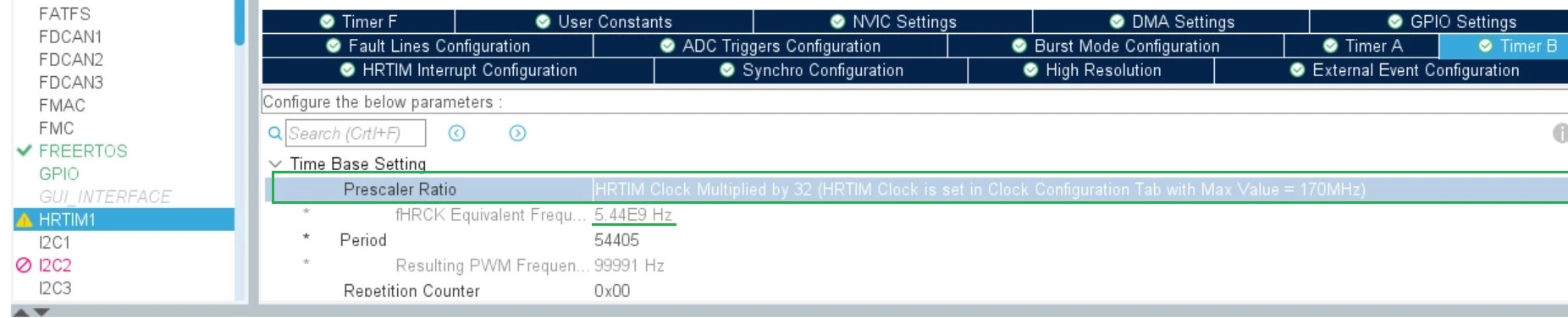

0693W000007D2XpQAK.jpgOnce High Resolution is enabled, it will be possible HRTIM Clock Multiplied by 32 prescaler ratio through the Timer B window tab:
Those are the steps in order to increase fHRCK to 5.44GHz.
