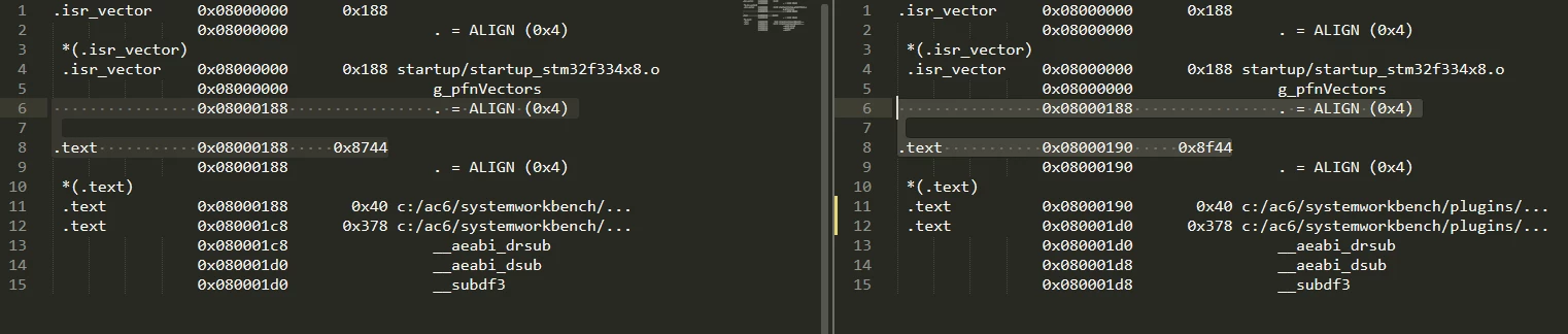

I noticed that my .text section gets mapped at one of two different addresses depending on my build. In one instance the hex file had a small (8 byte) gap in it which was causing some issues with some hex file parsing that I do. I've since worked around that, but now I'm curious as to the root cause.
I've been able to reproduce the two different results by commenting out a single print statement. I'm not an expert with linkers so I was hoping someone could help:
  1. Explain why this might happen?
  2. Suggest what I could do to ensure no gap in the hex file
This is on an STM32F3, using the CubeMX generated System Workbench project. Here's the relevant part of the linked script (the .ld is unchanged from the auto generated one) and the relevant sections of the two resulting .map files.

I tried forcing the two sections to be contiguous, which then gives me a linker error. I'm confounded as to what might be using those few addresses:
cannot move location counter backwards (from 08000190 to 08000188)

Perhaps it has nothing to do with the linker / scripts, but rather alignment flagged on sections within the object files, or by the compiler in different modes (optimization). I really don't have enough data to know, and I'm not using CubeMX/IDE
You'd perhaps want to inspect the .ELF objects for content / flagging
