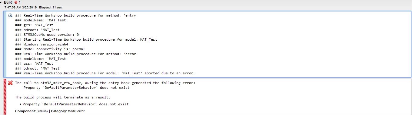

why do I get this error during the build process?
  • March 20, 2019
  • 1 reply
  • 782 views
I get the following error. Unfortunately, I can not fix that. The call to stm32_make_rtw_hook during the entry hooks generated the following error: The DefaultParameterBehavior property does not exist The build process will be terminated. to the software: STM32 MAT / Target V 4.2.2 and Matlab 2014a.

Hi @Samuel​  ,
The version 5.1.0 of STM32-MAT/TARGET has just been released at the end of July 2019.
Be aware that a lot of changes were involved in this release (in detail, alignment with STM32CubeMX version 5.1.0 and Matlab 2018b).
It is strongly recommended to upgrade to the most recent version of STM32-MAT/TARGET.
Regards.
